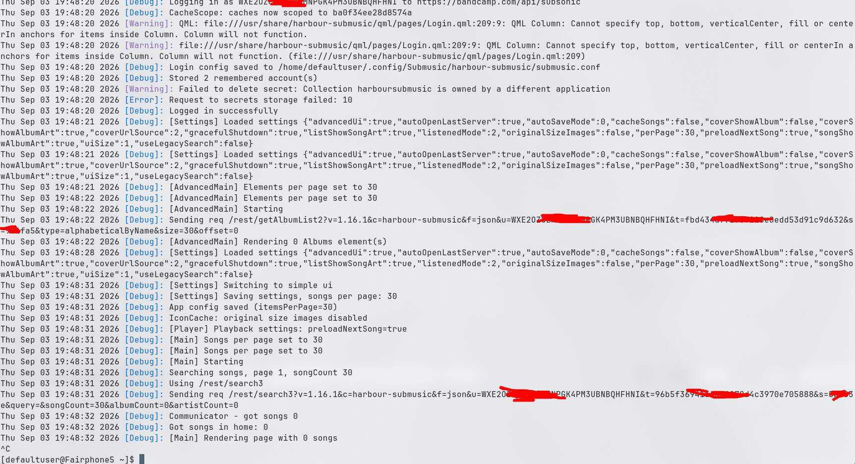

Hi. I just pushed a small change, which allows to change albums images source for api calls for albums. From what I found, bandcamp only provides coverArt. Would you mind testing it in your free time ?
  • Install the app
  • Open it in terminal with debugging: `harbour-submusic --debug`
  • Settings => caching
  • Remove all cached images
  • Try to use albums
  • If still no images, Settings => APi and switch from covertArt to albumId for albums.
  • Try to use albums
Link: Making sure you're not a bot!
Thanks <3
With “album cover url” set to “CoverArt” I now get a URL in the icon files instead of the error messages, e.g. ‘https://f4.bcbits.com/img/a3046703141_16.jpg’
But no images showing at all. Looks like it is trying to read the file with the url as an image? But I only base that on the many “unsupported image format” messages still rolling by

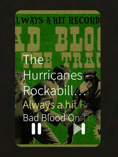

The cover while playing looks amazing though:
