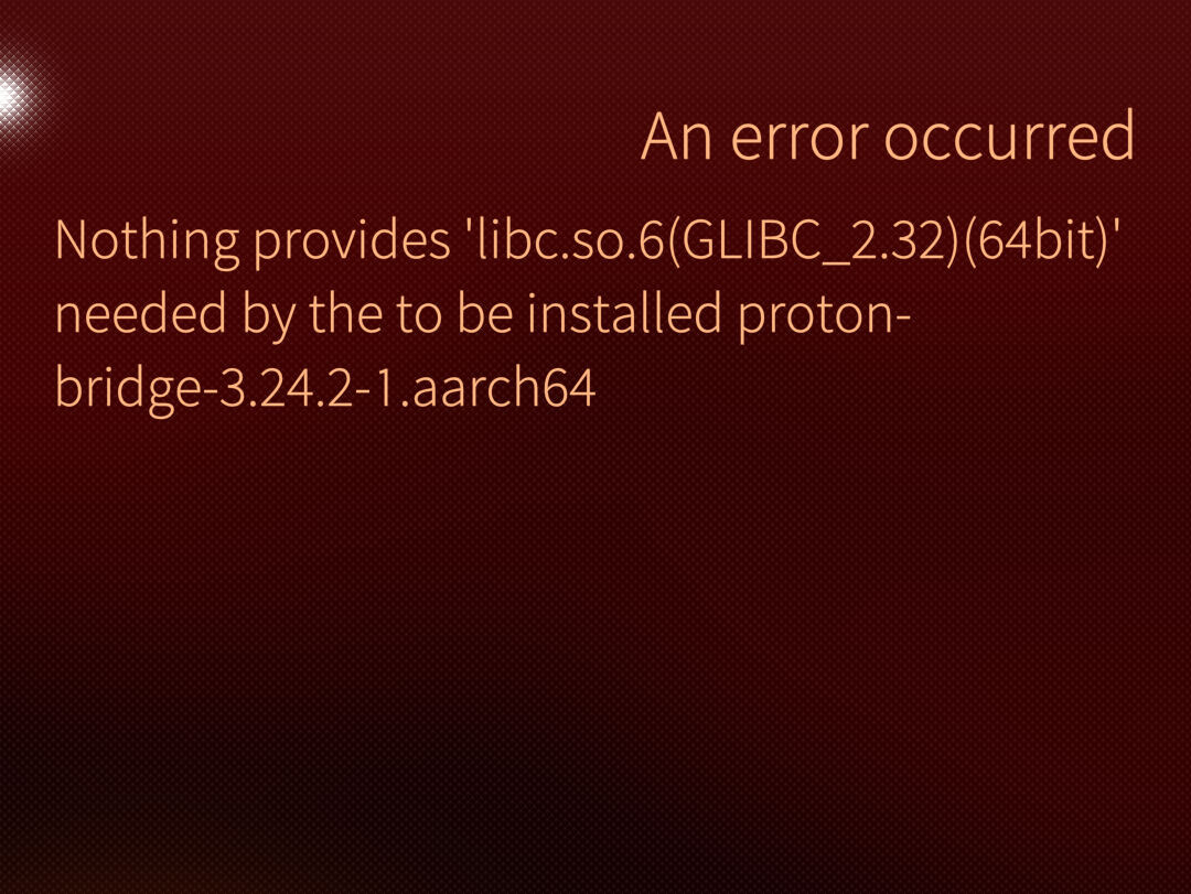

When trying to set up the Proton Mail bridge (from Harbour) I get a missing dependency for glibc 2.32:

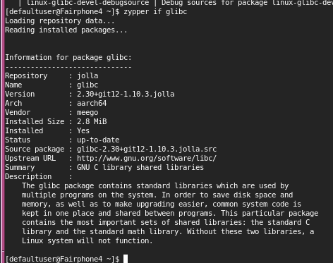

When looking closer with zypper I can see that only 2.30 is provided:
Are there any known workarounds for this? Would it be to try and compile everything locally with 2.30 and hope for the best or anything more “sensible”?

Probably the easiest way is to update the device to Sailfish OS 5.1.0.11.
Would this require switching to an experimental/testing branch? In the updater in settings it says that I am up to date on Tampella 5.0.0.72. This is for fp4
No need to change repos or anything, just follow the usual update instructions as mentioned in first message in the thread but use version 5.1.0.11 in the “ssu re” command. That is possible for FP4 and FP5, not yet for FP2 in case someone else thinks about updating.
This worked, thanks!
