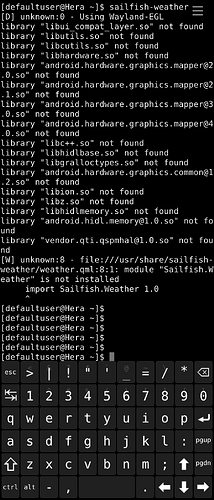

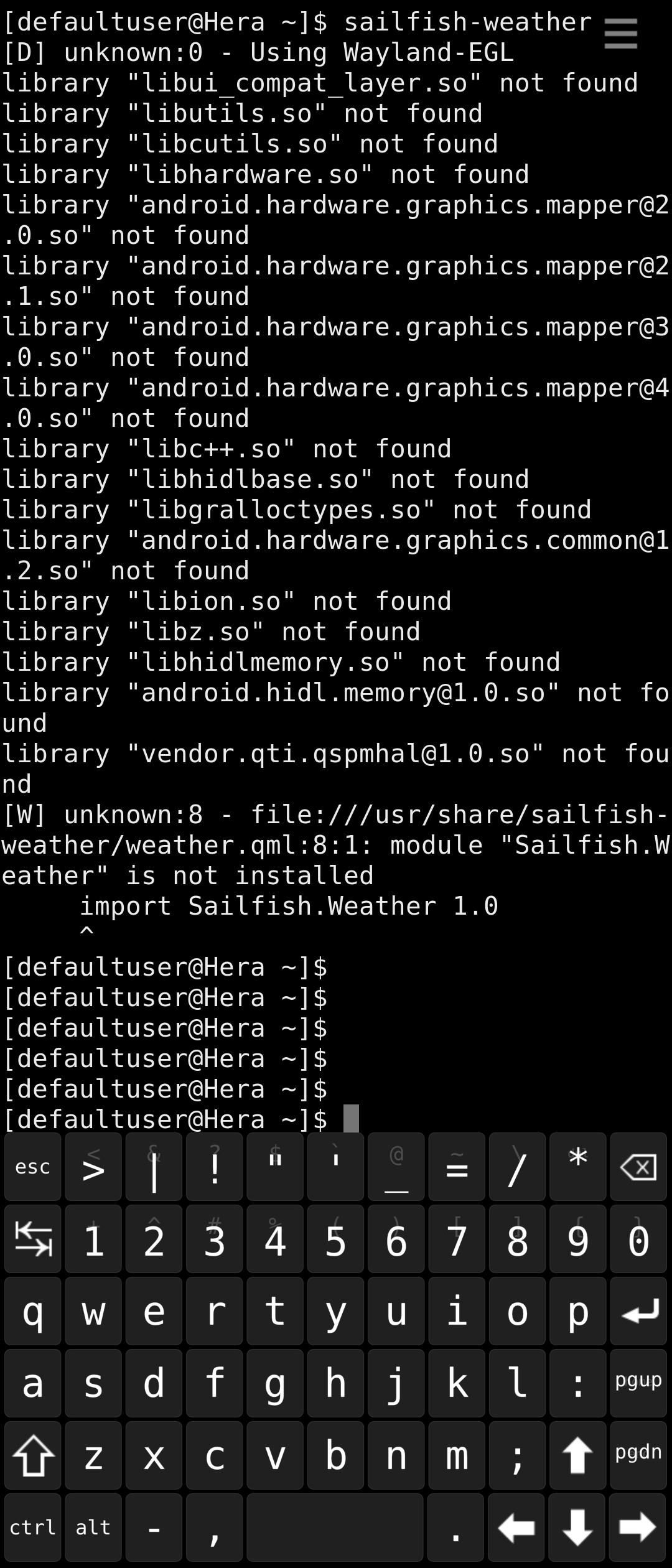

This is what I get when I start weather from the terminal:
It looks like an essential part of the app is missing. I have no idea why. Since remove-reinstall didn’t work for you, I also don’t have any suggestions on how to fix it.

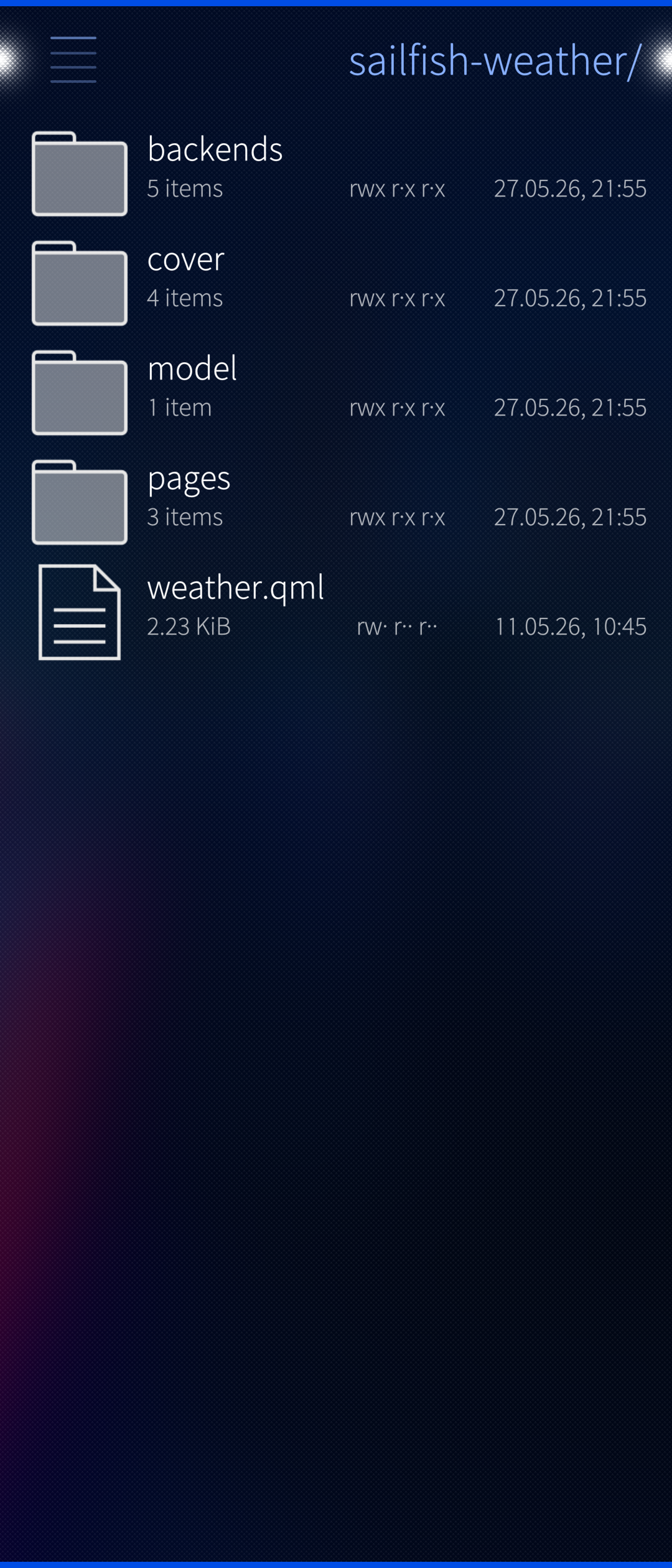

What is in /usr/share/sailfish-weather for you?
I compared what was on my Xperia 10 v (weather working) with my 10 iii (weather not working). On the 10 iii a whole directory ‘backends’ was missing. I copied it over from my 10 v to 10 iii, checked permissions, owner, group were the same, but sadly it made no difference.
Everything else in /usr/share/, /home/ defaultuser/.local, .cache and .config are identical … But it still doesn’t work on the 10iii.
I’ve unistalled/reinstalling weather many times. Reinstalled Weather does NOT install the ‘backends’ directory (this maybe intentional of course.

Could you maybe uninstall Weather on the non-working device, wipe every folder which might contain something weather related, reinstall Weather but before launching it copy everything from /usr/share/sailfish-weather from the working device to the non-working device?
Tried that, but it still doesn’t work sadly.
Okay since I don’t know how this works internally, I’m unfortunately out of ideas.

Does it still have the same error message when you start it via terminal?
Yes, exactlty the same error message.

Running the weather app from the command line there are a load of Android libraries not found (why, as Sailfish Weather is a native app?), but what seems to be of more consequence is this:
[W] unknown:8 - file:///usr/share/sailfish-
weather/weather.qml:8:1: module “Sailfish.Weather” is not installed
If I look at the weather.qml file I see that line 8 is:
Import Sailfish.Weather 1.0
So it seems to be telling me its trying to import a library or module that doesn’t exist on my phone and is NOT installed when you install the Jolla weather app from the Jolla store.
