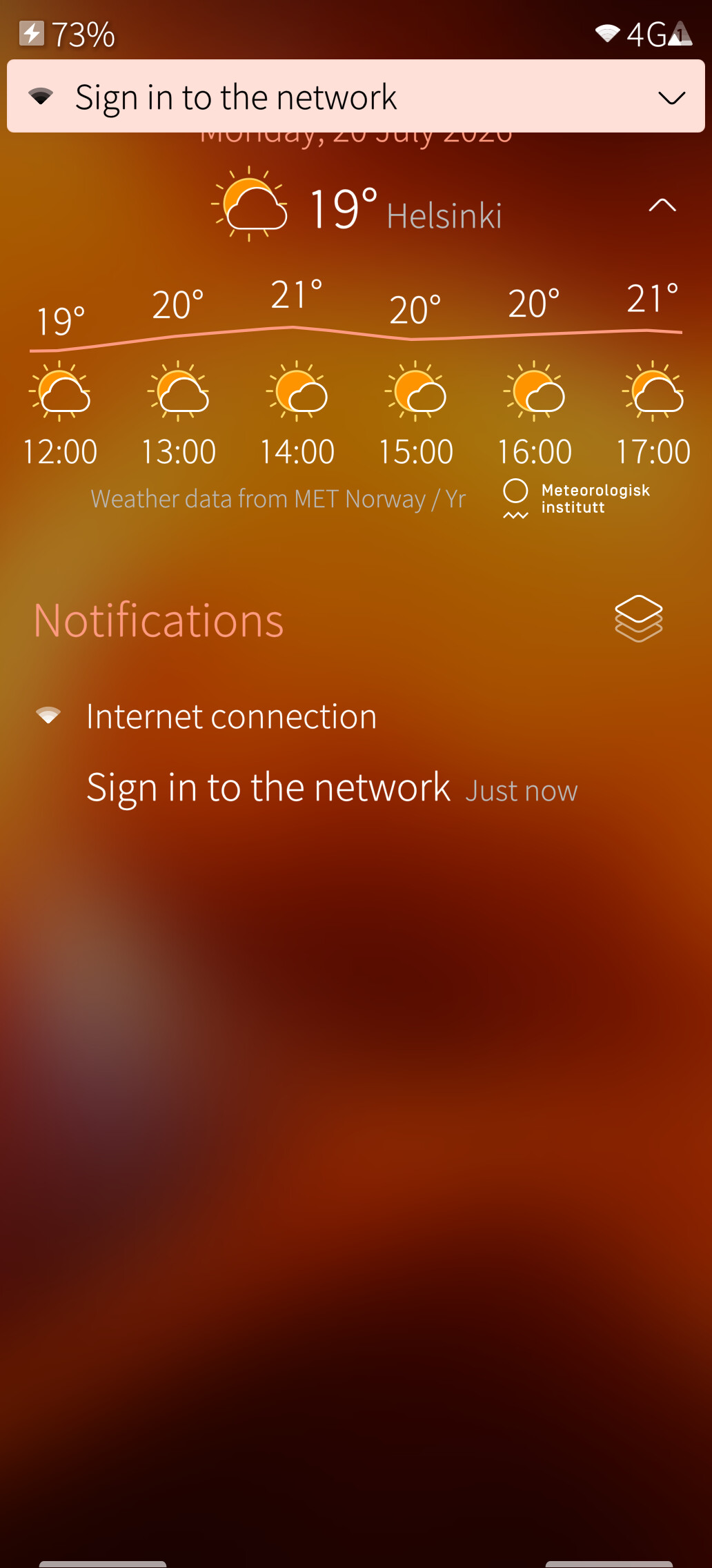

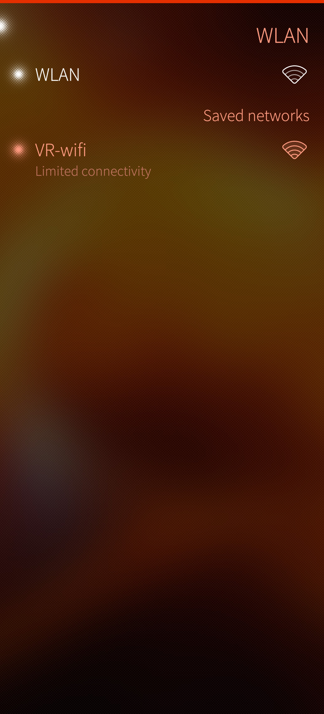

Trying to connect to an public wifi on train in finnland (VR). After connect i get a popup to “sign in into the network” after click browser opens but nothing happens. See screenshots attatched

  2. connect to VR wlan
  3. click on authenticate

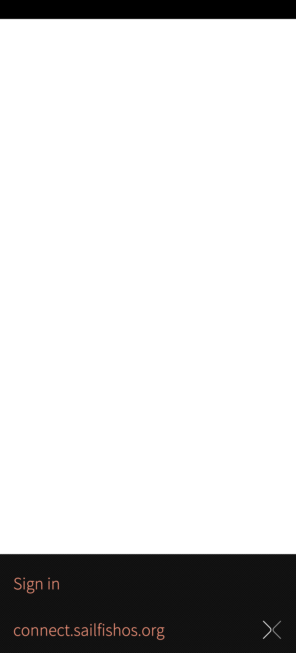

  4. browser opens with sign in button
  5. nothing happens if you click
Open other browser. See connectivity is possible
Browser did not connect

You can try to visit http://neverssl.com in a browser (making sure to type in http://, else the browser will likely default to HTTPS, and fail because of the portal - make a bookmark for the next time).
Should give the same effect as the CPH app - showing a simple web page over a non-encrypted link that the portal can intercept and let you activate internet access.
