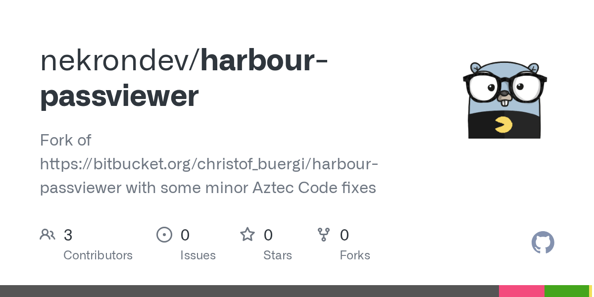

The fix is related to message encoding and the zint library which had been vendored in the project. A working version can be found here:

I’d love to test it, but I would need 32 bit version
Hi David, I added the build for armv7hl. Have fun.

Will you create a pull request upstream?

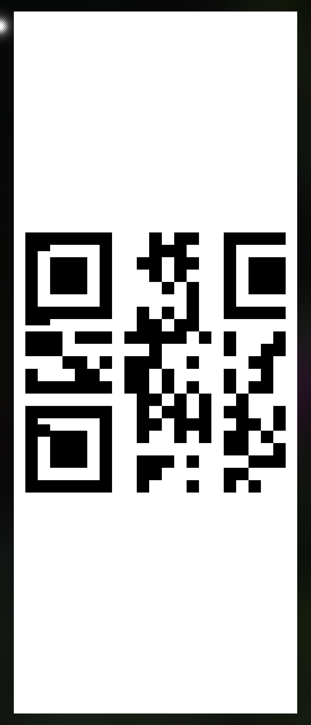

While your version correctly displays Aztec codes such as the Deutschlandticket, tickets with QR codes are broken :confused:
Sorry for this issue, the backported (and cherry-picked) Aztec code messed up 7-bit and 8-bit encoding so that common QR codes would render incorrectly.
The new v1.8.2 available on Github fixes this issue.
