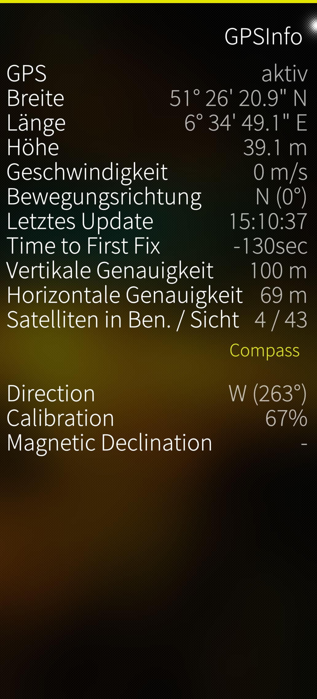

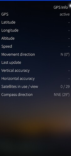

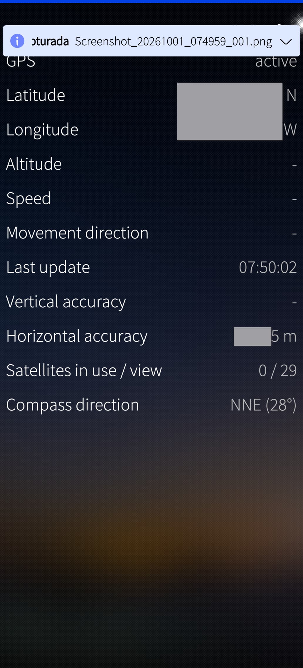

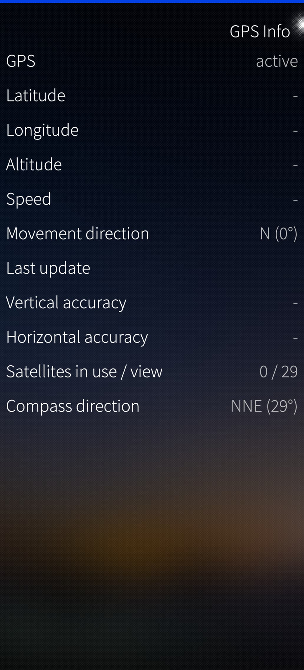

After connecting Location, I get “0/29” nearly immediately. Per visible timestamps, it took 3 seconds to find my exact location (I still had the “screenshot” notification displayed), thanks to beaconDB.
After 10 minutes passed, I am at “0/41”, I guess satellites are moving in and out of my horizon so I should see 41. I am still at 0 used because I am inside.

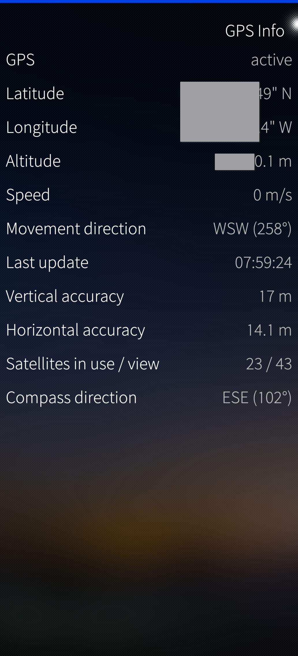

I get close to a window. Within a second, it uses 23 satellites:
If I get far from the window, the number decreases from 23 to a low number within seconds.
I am back at my chair and it still reports 6/43. It still can detect a few satellites now that it saw them at the window, and a weak signal can still be received. This part is a bit surprising to me, why I wouldn’t get the 6 satellites earlier if the signal can be received even at my chair inside.

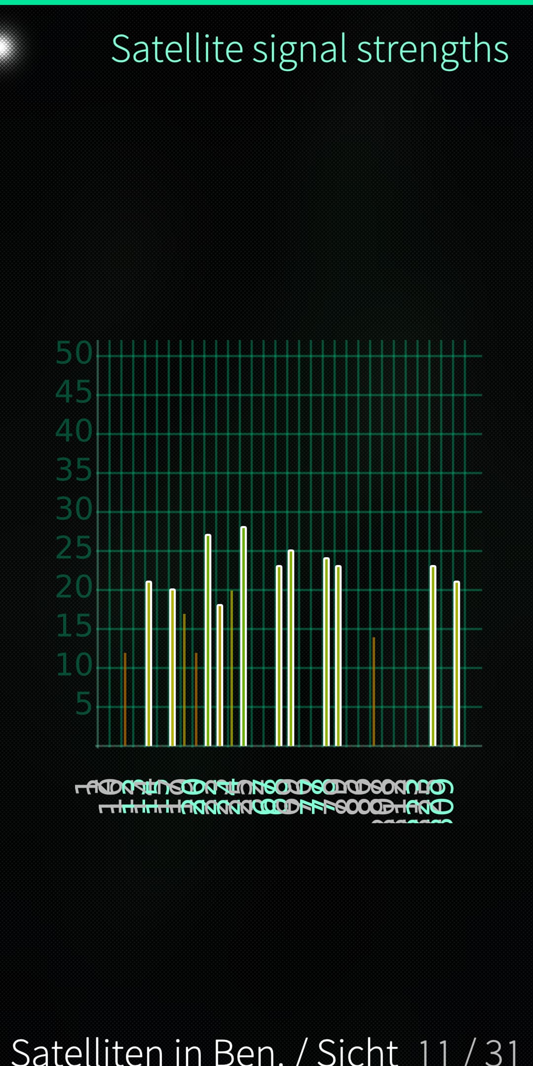

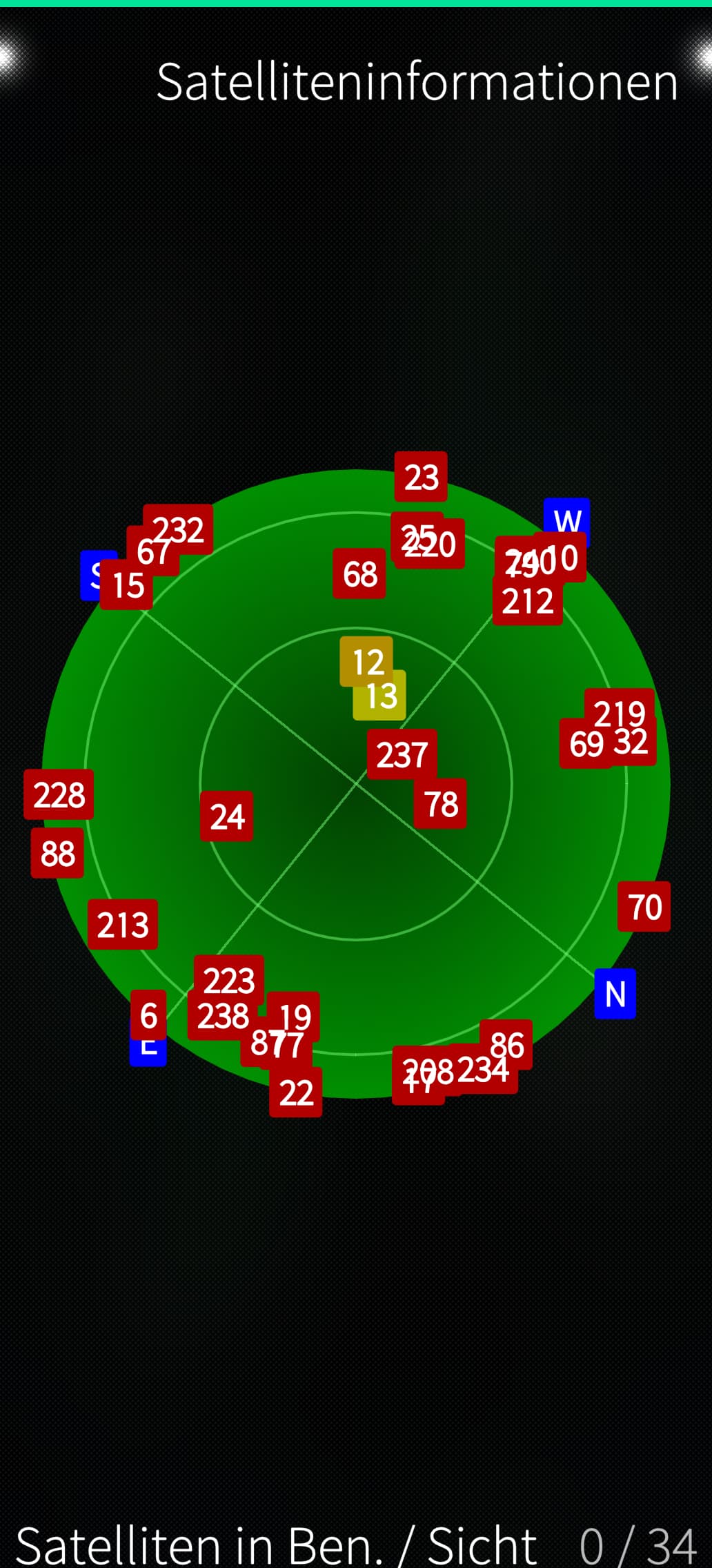

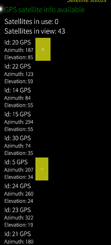

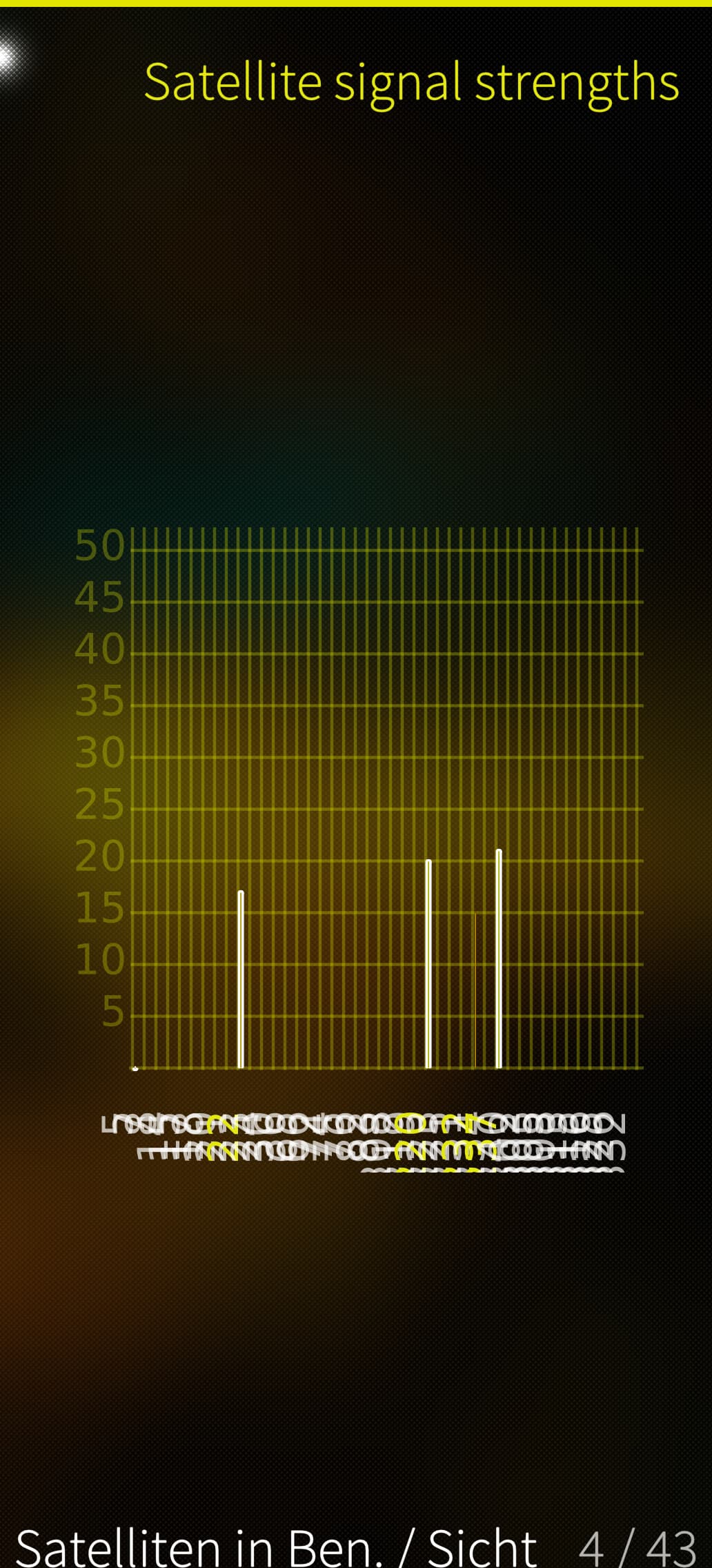

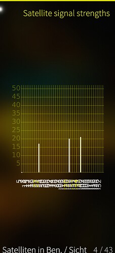

I can see in the 4th image you added in the first message that there is signal strength for at least one satellite so it can see that. The yellow bar after the satellites in the list in CSD app. How many of those with a yellow bar do you see when you are outside?
On that day (and on the second attempt later), only this one satellite was shown. And yes, i have scrolled the list down.
And that test was done outside?
Yes, in perfect weather – hardly any clouds at all.

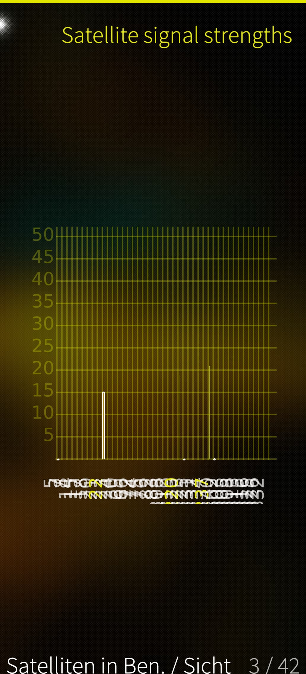

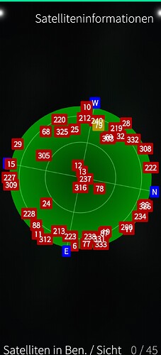

I repeated the test today with the new OS version under heavy cloud cover and with just a few small raindrops.
This time, it managed to connect up to 5 out of 45 satellites – but only briefly.
Even when I held my hand over the phone to take a screenshot, they were gone again. Most of the time, the count was 0 out of 40+. If it doesn’t rain, I’ll run another test tomorrow with both Sailfish phones.

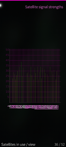

Not sure the almanac/agps/beacondb discussion etc has anything to do with it, a properly working gps chip in J2 has graph like this in gpsinfo within seconds, seems like a barely working chip that can get some signal sneaked through QA, but waaaay off the standard and should fall under warranty
Are you using “Device-only mode”, or some other mode (with online or cell-tower data support) in Settings > Location?
The standard high-accuracy positioning option in settings, again online sources should not inhibit getting signal strength reported from sats, they help speed up calculations as data transfer straight from sats is slow, barely any sats displaying signal strength seems like a borked gps chip

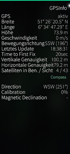

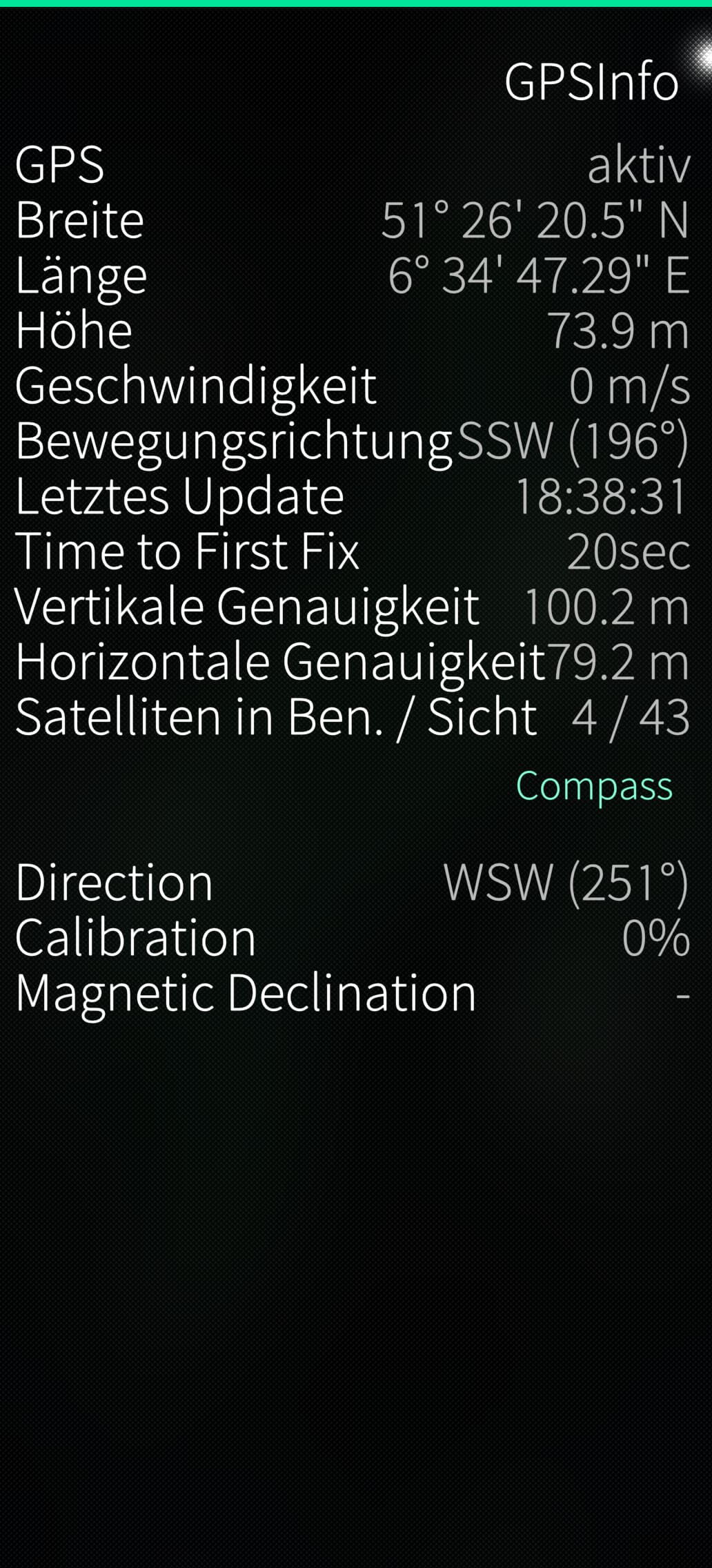

Factory reset and comparison with the XA2+:
Settings: Mobile Data: on, GPS: on, GPS setting: high-accuracy positioning.
J2: Test duration approx. 1 hour, XA2+: Test duration 15 minutes.

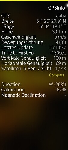

Although the J2 acquired a fix after 20 seconds, it took 10 minutes before more than 2 satellites were available for positioning. After those 10 minutes, I saw for the first time a period during which it could have navigated. For 3–4 minutes, it was able to maintain a continuous connection to between 3 and 5 satellites. The rest of the time, the device no longer had sufficient connections. Sometimes one satellite was green, sometimes two, then just one again. I must have switched the mobile on at least five times during that hour. The result was always 0/approx. 45.
The next Image are 20 Sek after start after the first fix.
The next Image is 10 Minutes after start with finding enough satellites and i was able to route for 3-4 Minutes:
At the rest of the time i have approximately that result:

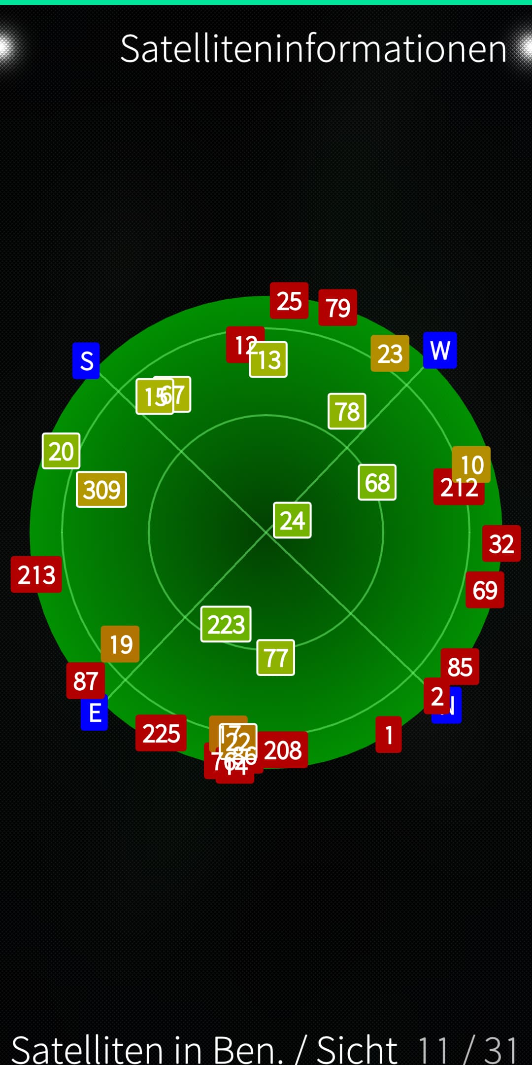

The Fix an able to route after 11 Sec with my XA2+
Admittedly, the signal strength isn’t exactly brilliant, but this device has never let me down when it comes to navigation.
