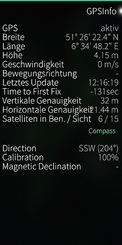

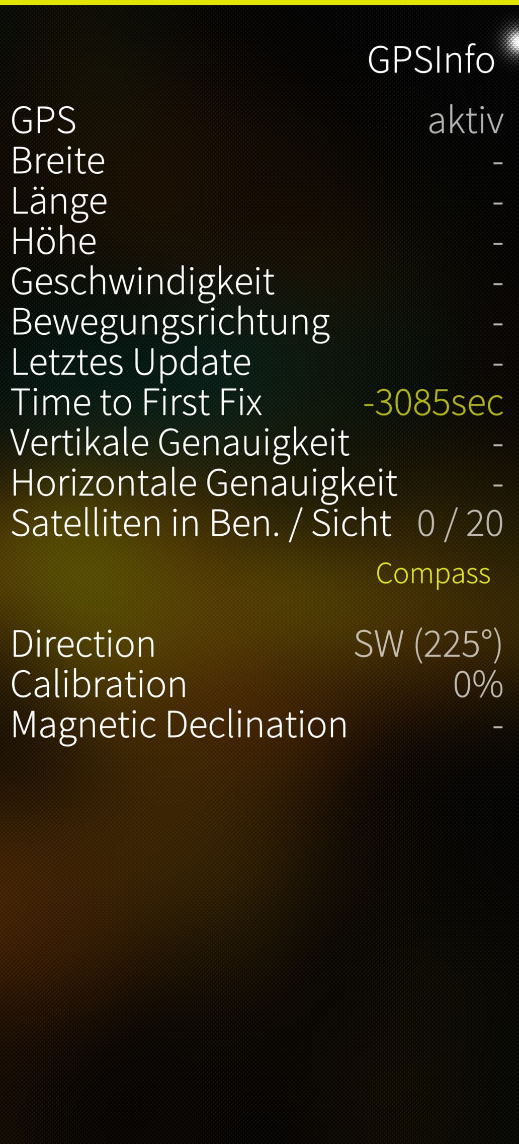

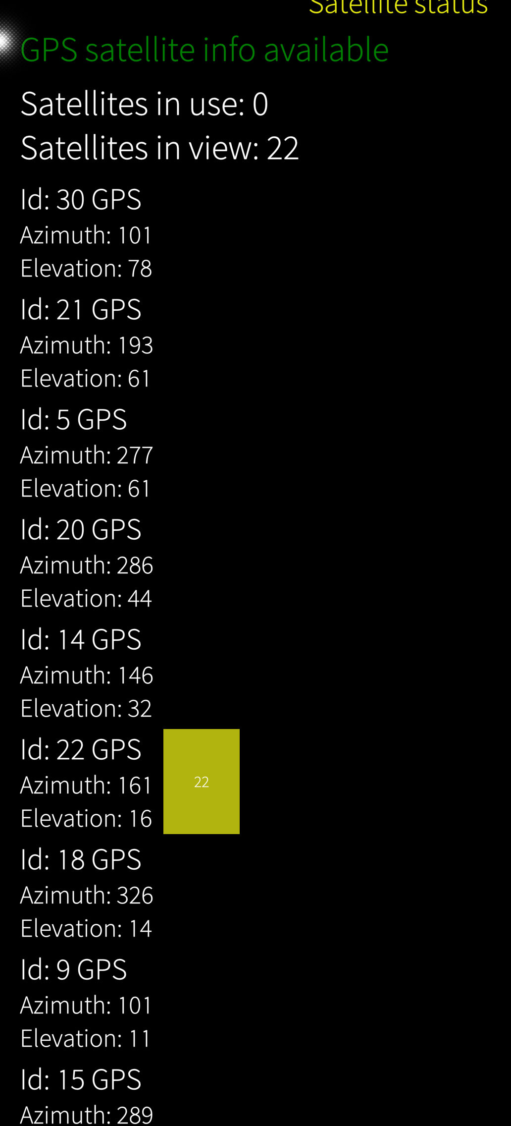

Out of 4 tests, 3 times there were no usable satellites

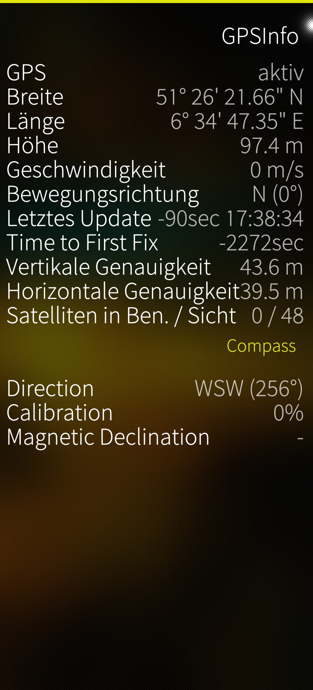

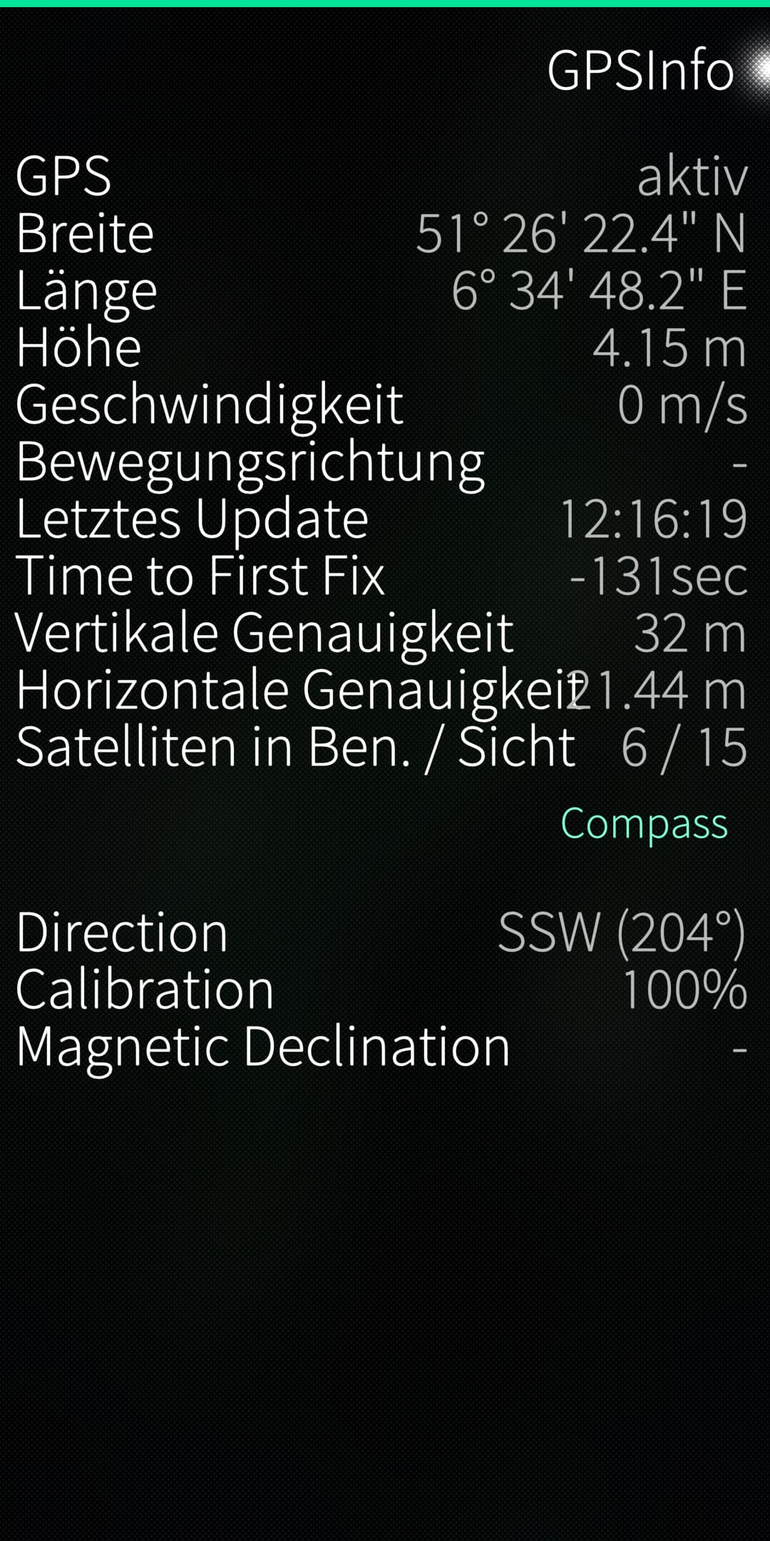

First try: spent 55 minutes searching for satellites, then rebooted and repeated the process for 1 hour. Comparison image from the XA2+, which acquired a fix with usable satellites after 2 minutes. CSD images from the J2 and XA2+ are attached.

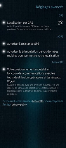

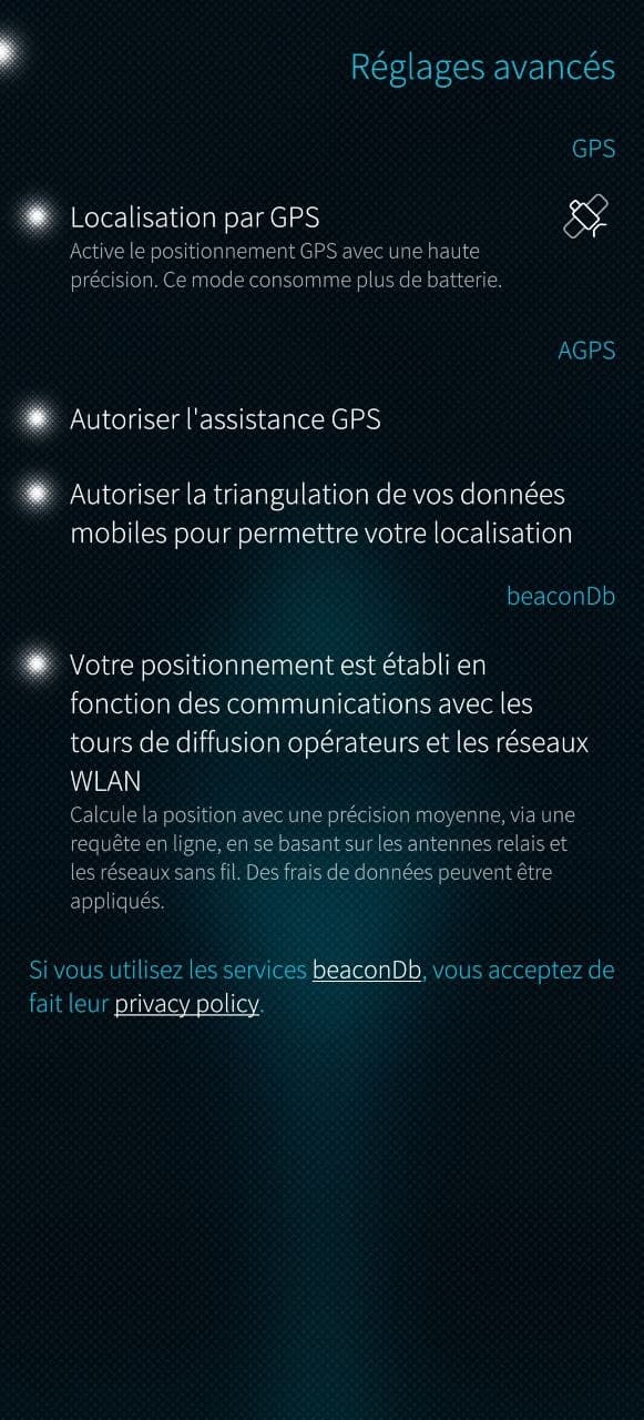

Flight mode is out and GPS is active/on - after that i have started the App GPSinfo. Location setting → Custom: GPS position and both A-GPS. For a new trial i reboot the device.
see preconditions.
That, after a reasonable waiting period (depending on how long the device has been left unused), it detects usable satellites when i am outdoor.
No usable satellite…
no modification, but I use the App patchmanager (grater Icons on Appgrid)
The next 4 Image are from Jolla Phone 2026 (second image is from the second try - after i had reboot the device. I stopped the second try after an hour by saving the image.

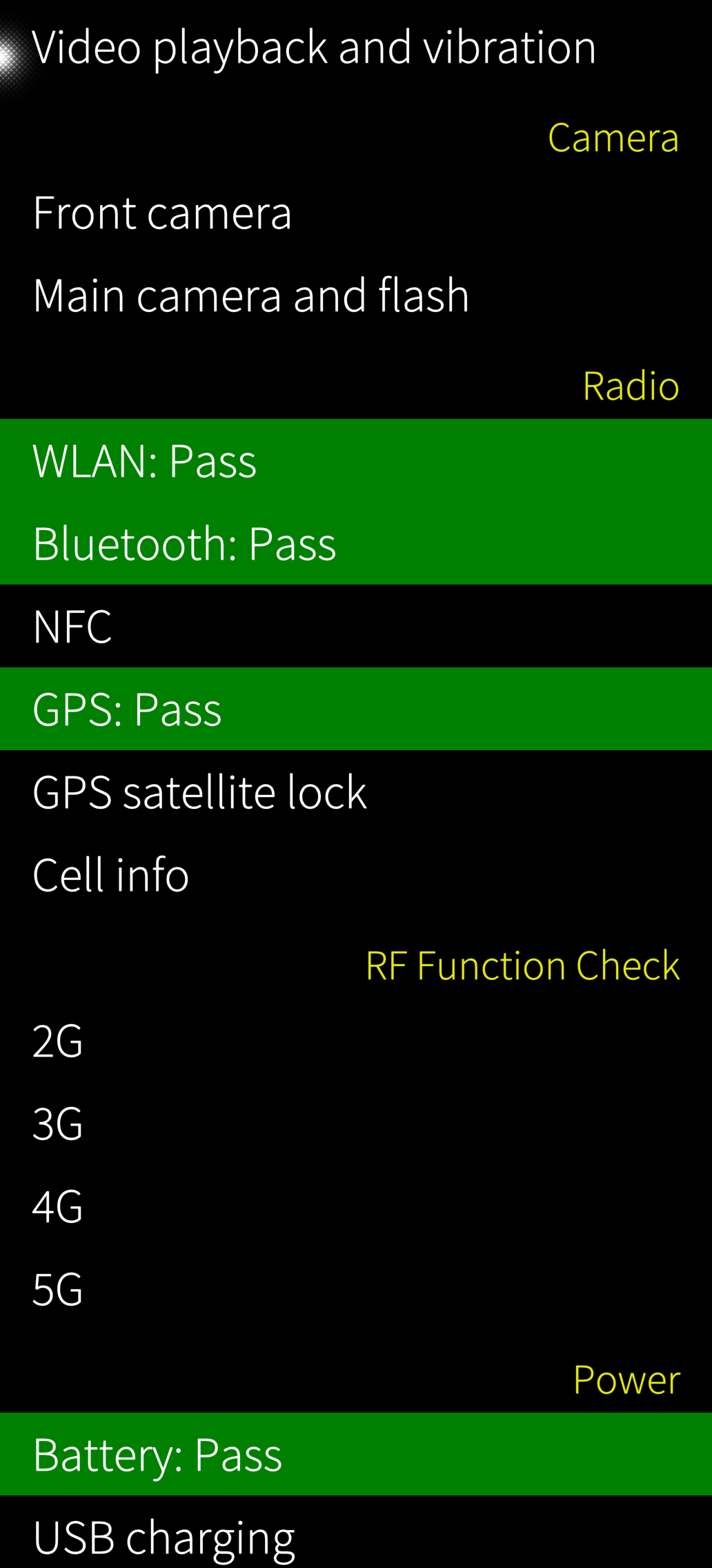

2 Picture are from the CSD-Tool

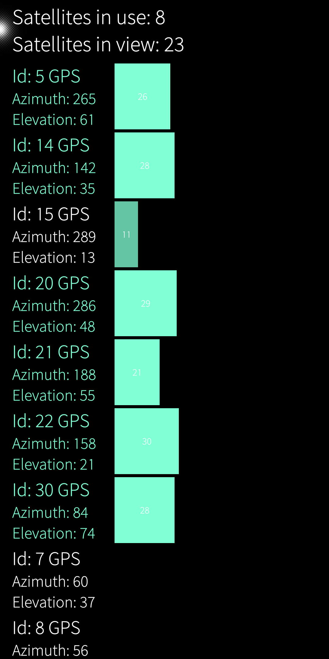

Next 2 image are from the XA2-Plus - Device. It was right next to the Jolla Phone (2026). After 2 minutes, it had a workable and usable synchronisation, and it wasn’t used for 2 months. Otherwise, the same settings as the Jolla Phone
Hi, have you changed the localisation settings to custom to allow the usage of beacondDB ?

I think beaconDB would not help here. GPSInfo gives a position and 19 satellites. That means it got some info from A-GPS (beaconDB would do the same, just maybe faster). The problem is it captures signal from 0 satellites out of the 19 it should be seeing. I would personally send it in warranty.

I’ve now tried out the two suggestions that were made. Here’s the result:
First image: Started at 5.00 pm with mobile data on. At 5.38 pm, it appears to have received some data (on the XA2, the clock runs continuously from that point onwards, as it naturally maintains the connection). At 6.00 pm, I stopped the test – no further updates – apart from the one at 5.38 pm.
Second image: GPS switched off for half an hour, then switched back on – mobile data is on. Start at 6.30 pm, finish at 7.30 pm

I can see all the satellites, but none of them are green.

I’ve no idea either, but if “The second value is the actual number of satellites seen by the device” is correct, then my device here in the room should surely be displaying a zero in the second position (mobile data:on, GPS:on) – but it isn’t. It counts up straight away: 0/18, 0/32…
To me, it looks as though these are the old almanac data that it has loaded from the cache, and it stops at 32 for the time being because it’s reloading new almanac data (for the current time). After all, the device can’t see any satellites here in the room, but only the Amanach data.
After some further checking it might be that the value could contain satellites it should be seeing. The documentation is not very accurate in that part. Do you ever see signal strength for satellites it lists in CSD app especially when testing outside?
