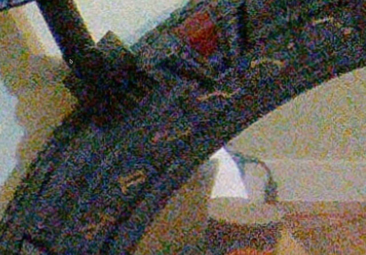

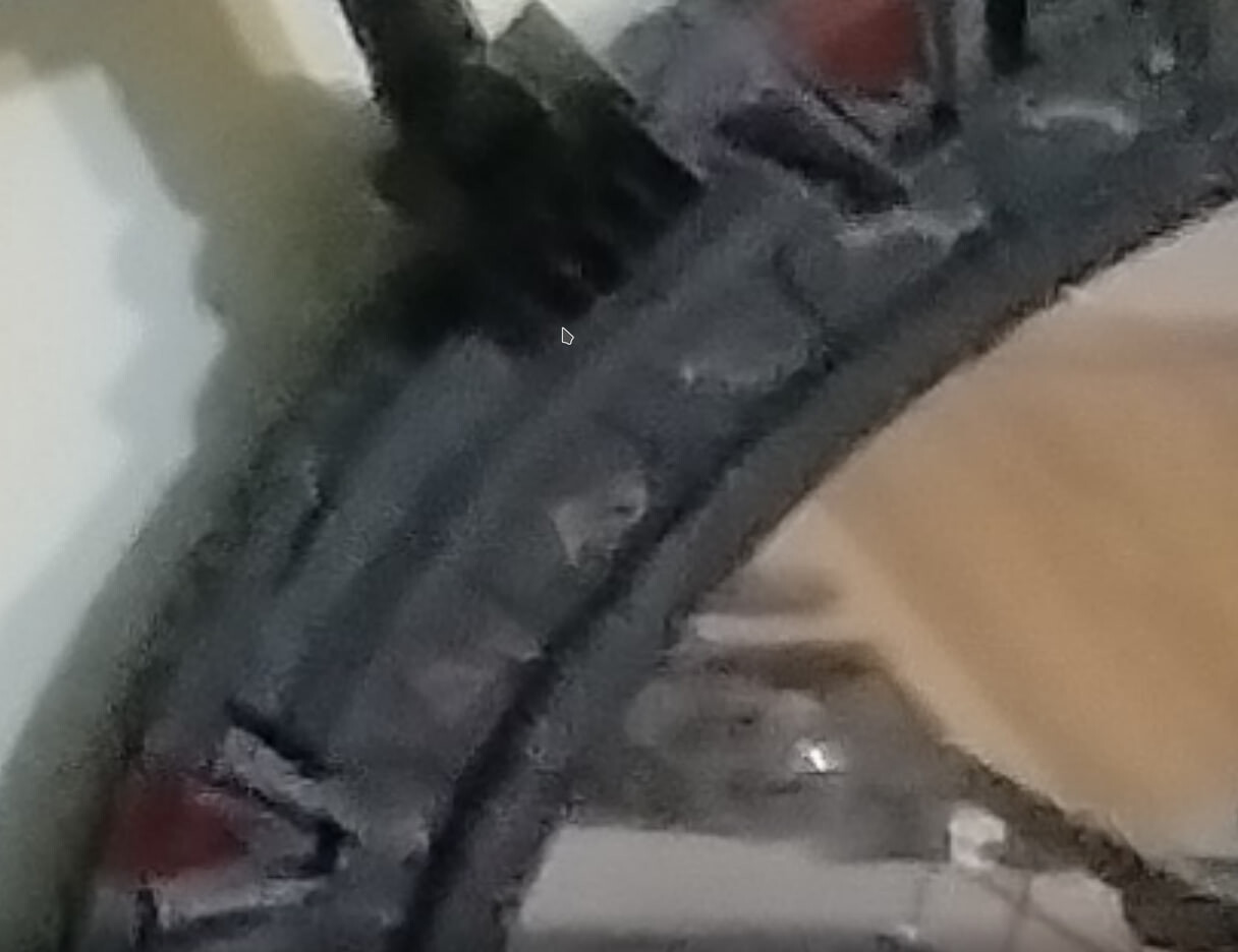

Hello, nice. But shy was denoising disabled? The pictures are so much worse than before
Because without deonoising pictures are so much better than before
For others who don’t see glaring difference.
Because of the denoising, detail is lost. A lot of detail. That’s why it was disabled.
“You can’t add new information through post processing, you can only distort it whenever your guesses aren’t well informed and Edge 30 Neo is a phone that certainly lacks a high quality ML denoising model that would visually clean up noise without glaring regressions that we can see in samples.”
you can turn it back on by doing setprop persist.camera.api1.isp_off false if you REALLY want
Simplest comparison
Noise, yes, but THE DETAILS
Ok, fhats fine. Now i can choose to disable noise when i need details and enable noise for pictures which i want to share with others. Miami camera is not powerful enough to get perfect results, so i like the denoised in darker light situations more.
You can always denoise it in like gimp and do much better job than the inbuilt algorithm
