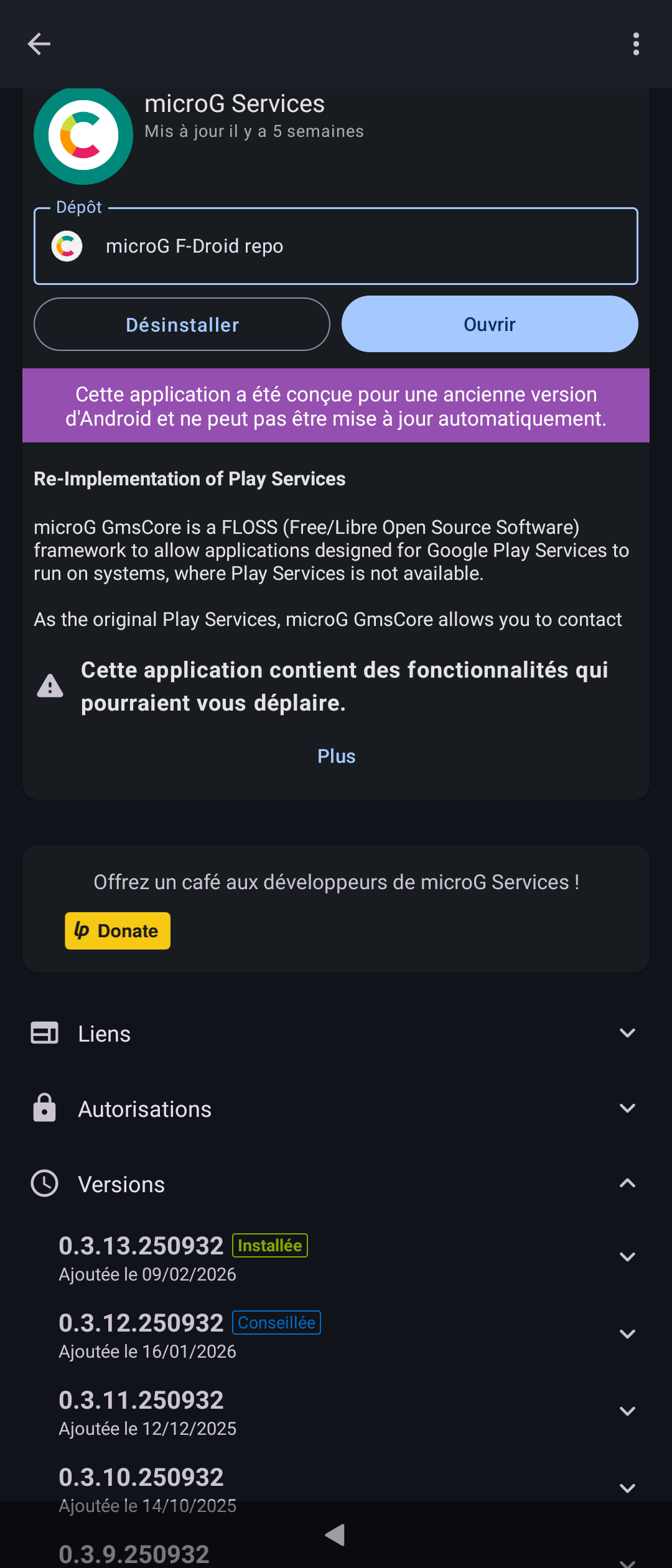

If you installed microg through FDroid, check if you have the last version because, by default, Fdroid don’t install the last version. You need to go to Fdroid, search for Microg and check the version installed at the bottom for Microg Services and Companion. You can choose to install the last version
Good tip! Didn’t know about this
Should we start a separate threat with issues and possible solutions to those regarding mircoG?
I have noticed that on different SFOS phones mircoG works or behaves differently even though I followed the good instructions made by flypig (Jolla).
By default F-Droid installs the “recommended” version, sometimes it is the latest, sometimes not. Installing the newest version, when it isn’t recommended, sometimes fixes issues and sometimes it breaks stuff that worked before. If you install newer version than recommended and it causes more problems than it solves, then you can click the previous version in the F-Droid and easily downgrade back to previous version and wait for even newer version to arrive.
I had the same issue after having to uninstall and reinstall microg due to the latest SailfishOS update. Making sure to force latest version in fdroid fixed the login problem.
I can also confirm latest micro G fixed login problem on my 10III. Now ver 0.3.15. ………
