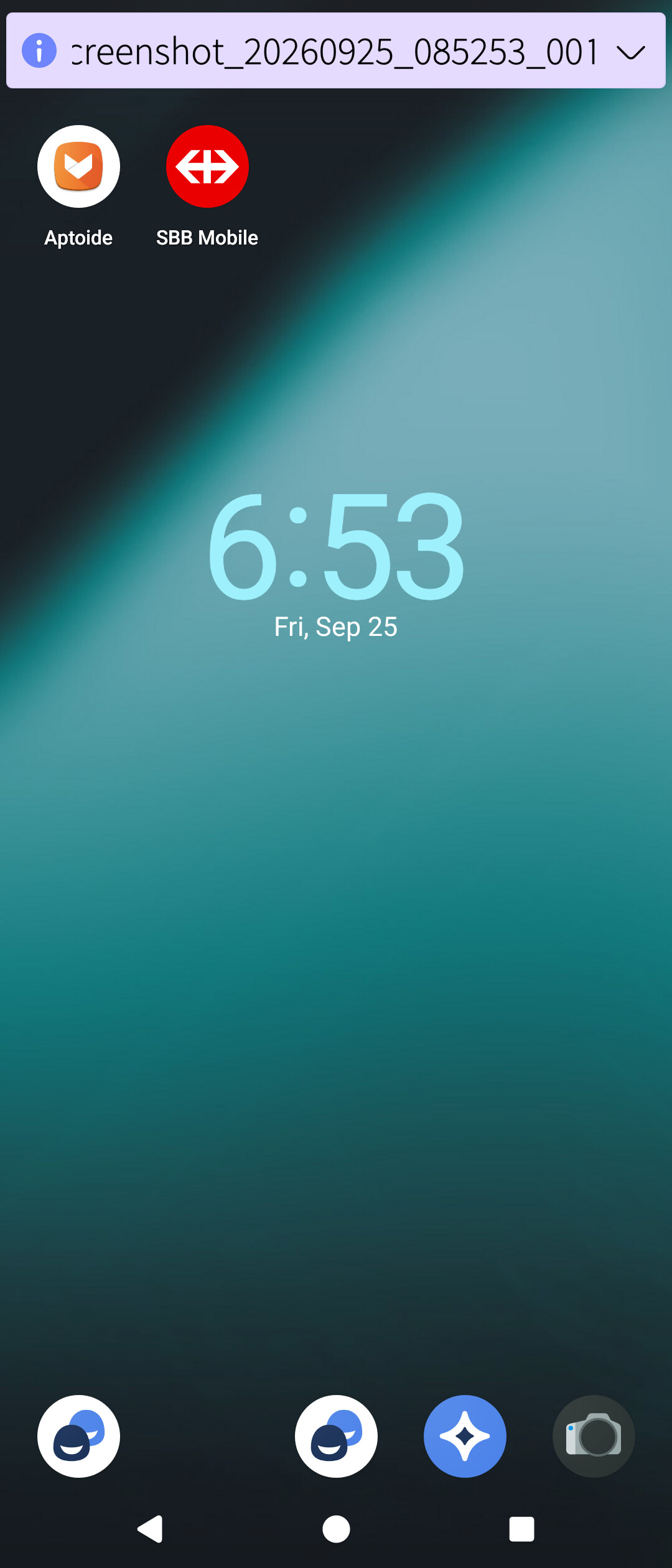

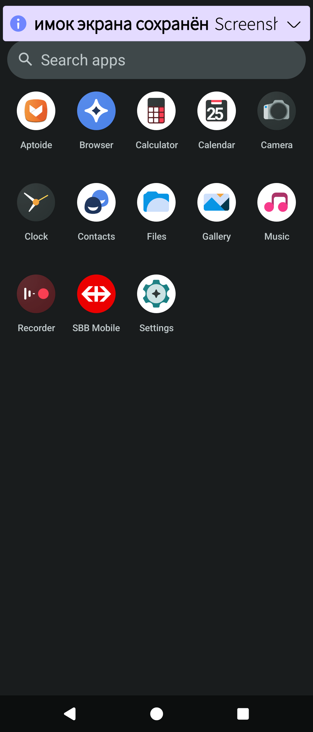

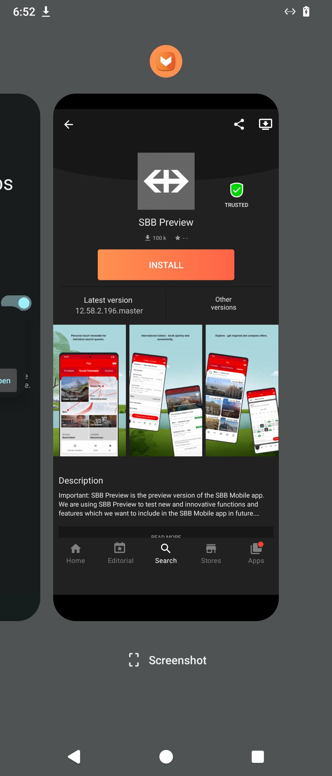

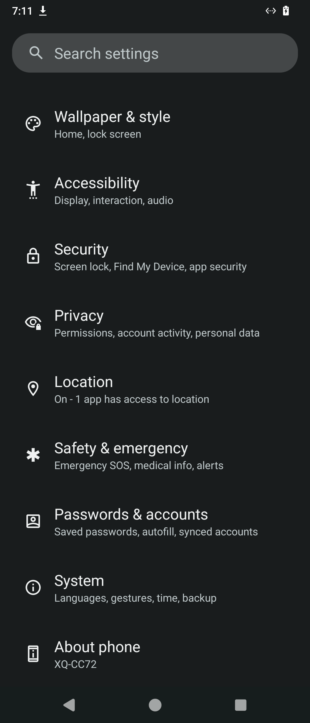

First thing i have remembered was missing to start mine community port to adopt Android App support - was missing flag in kernel that includes support of squash file system to be mounted. I was doing the trick that made my community port while connecting to Jolla store of applications it to present itself not like XQ-CC72 but like XQ-CC54 - for which i have the native license for AAS. Then after launching store - Android App Support - did appeared in the store to download. But installation was failing for some reason. When i asked AI to install parts from image of official port ant the rest from the repo - then i was getting that error of missing Squash FS support by kernel.
