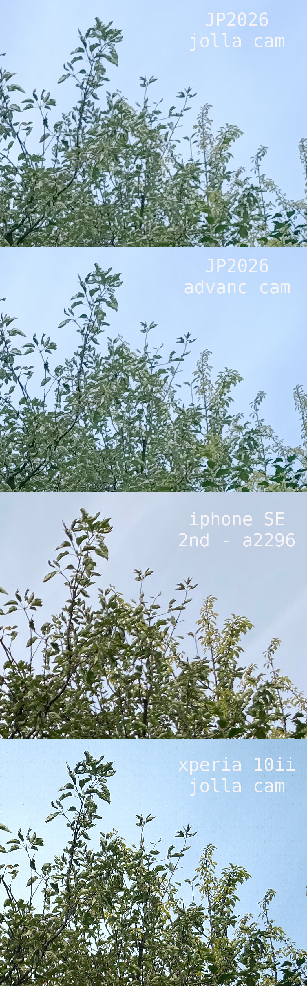

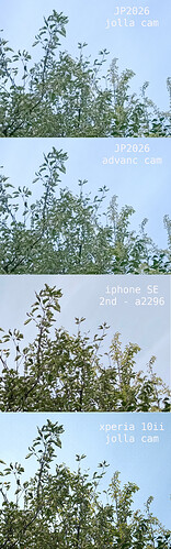

as the 0.5 lens producing very nice macros, the main lens is indeed like 10 years ago on low-end phones
compared by downsized to 4000x3000 and then cropped same area.
JP2026 - jolla cam - worst result
JP2026 - advanced cam - almost same but because more pixels it is sharper
iPhone SE 2nd gen (old phone) - way better
Xperia10ii (old phone too) - the best quality
I notice this same kind of “flatness” with the JP2026 camera. Have you tried HDR mode in Advanced Camera? Maybe it makes things better?
no notable difference

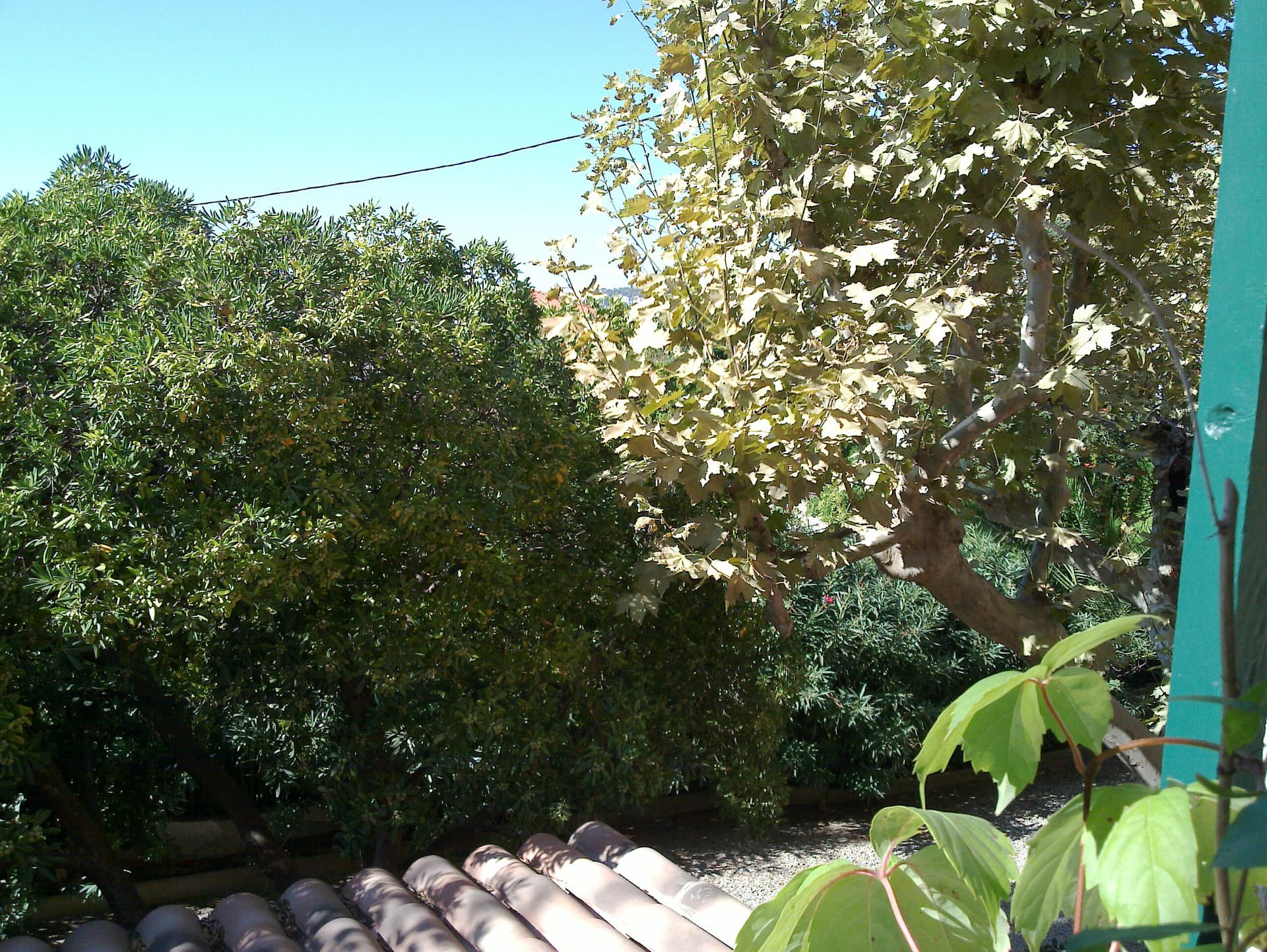

Just because why not, I made a comparison with the mythic Nokia N900 (2009).
Turns out it’s not totally out of interest.

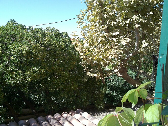

N900:
JP2:
Seems the JP2 is nicer, softer to the eyes
But on a closer look, something feels weird:
N900:
JP2:
Images from different eras, very different contrast.
This tend to show there is a real HDR work in the JP2 camera, a strange one.
But adjusting the contrast reduction that way makes the image look artificial, imho.
It’s as if the image had been repainted rather than merged from three images taken at different exposures.

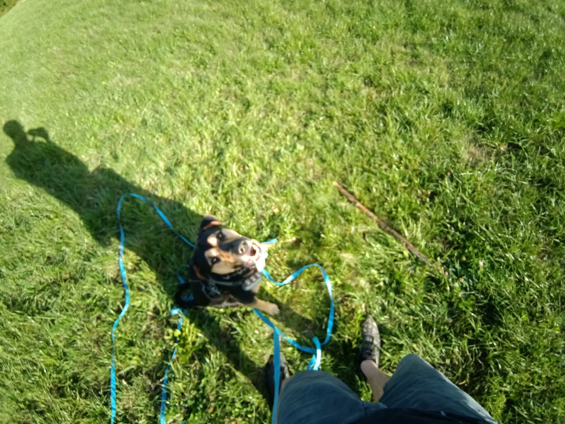

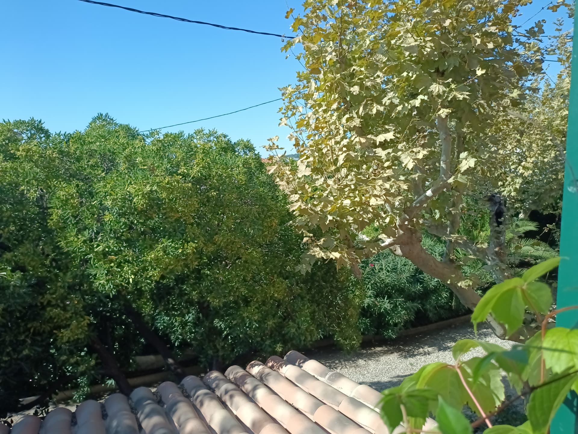

I am starting to believe, that there are multiple things that could be improved here: The tonemapping / HDR part has already been mentioned, but similar to that first post, I also believe, that there is something strange about the focussing.
I took these 2 pictures today, flipping back and forth between the dog and the background - you can see this by the exposure, higher when focusing on the dog, lower for the background. What did not change, however is the actual focus point: The background remains blurry in both photos.

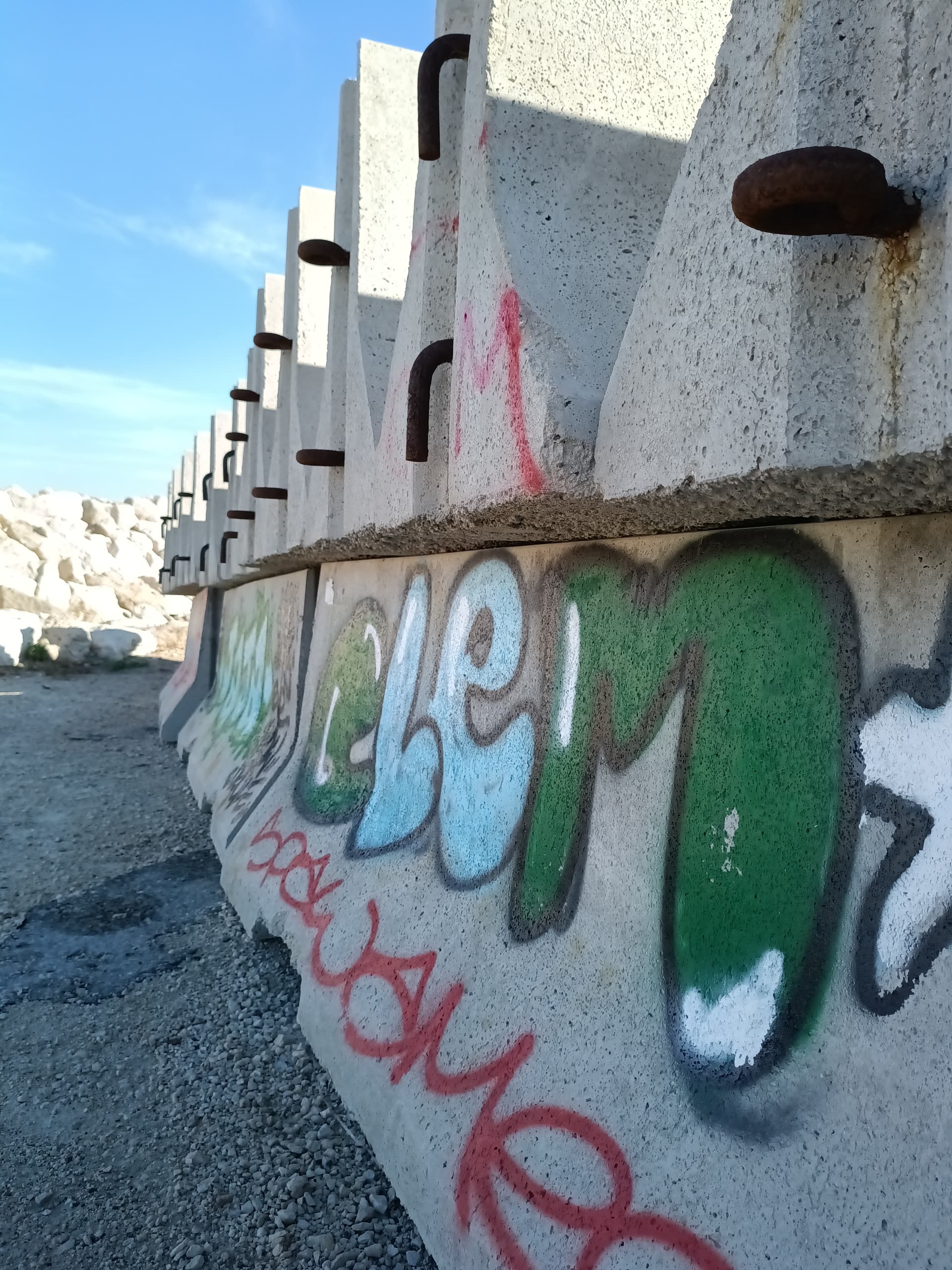

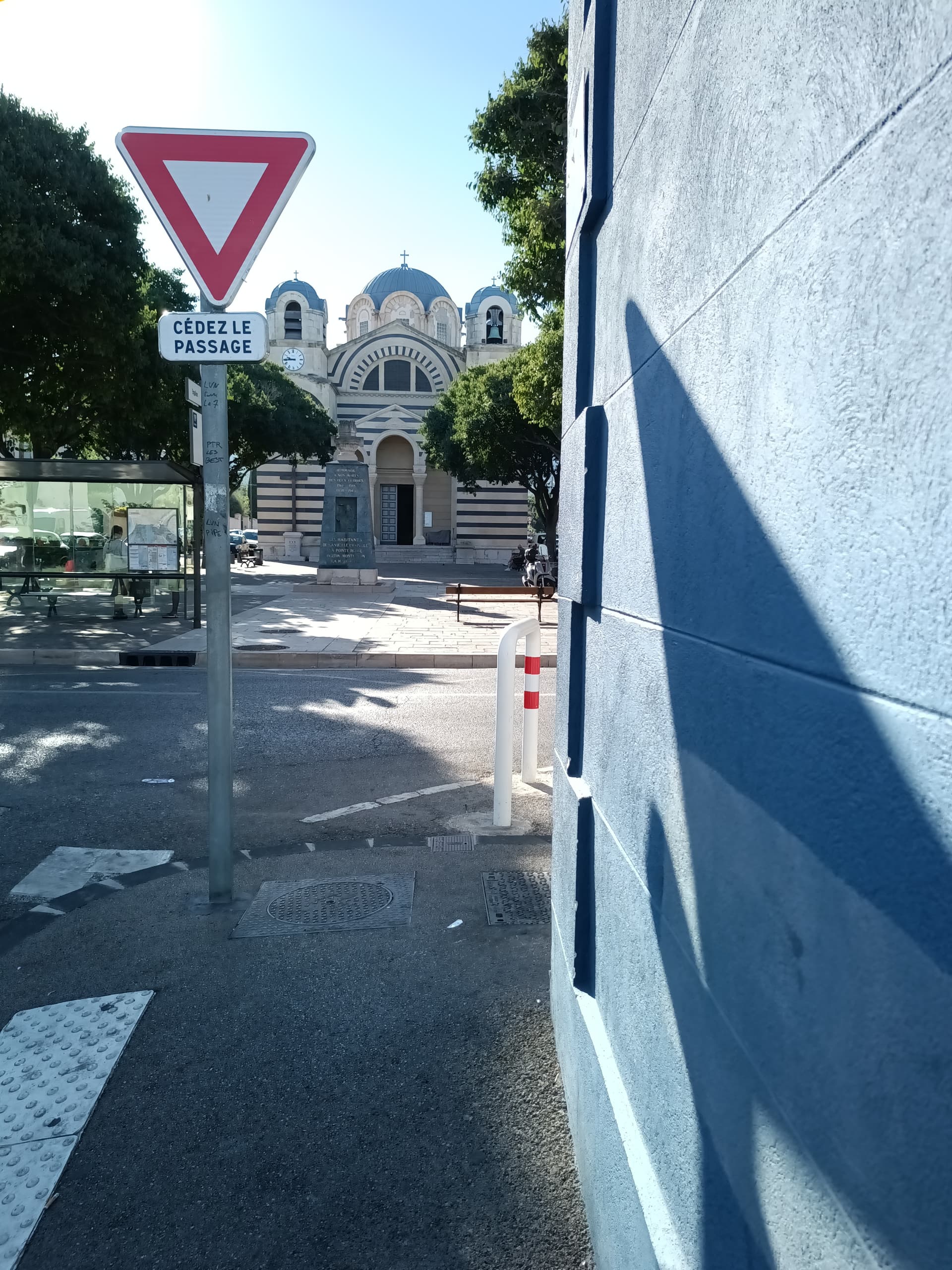

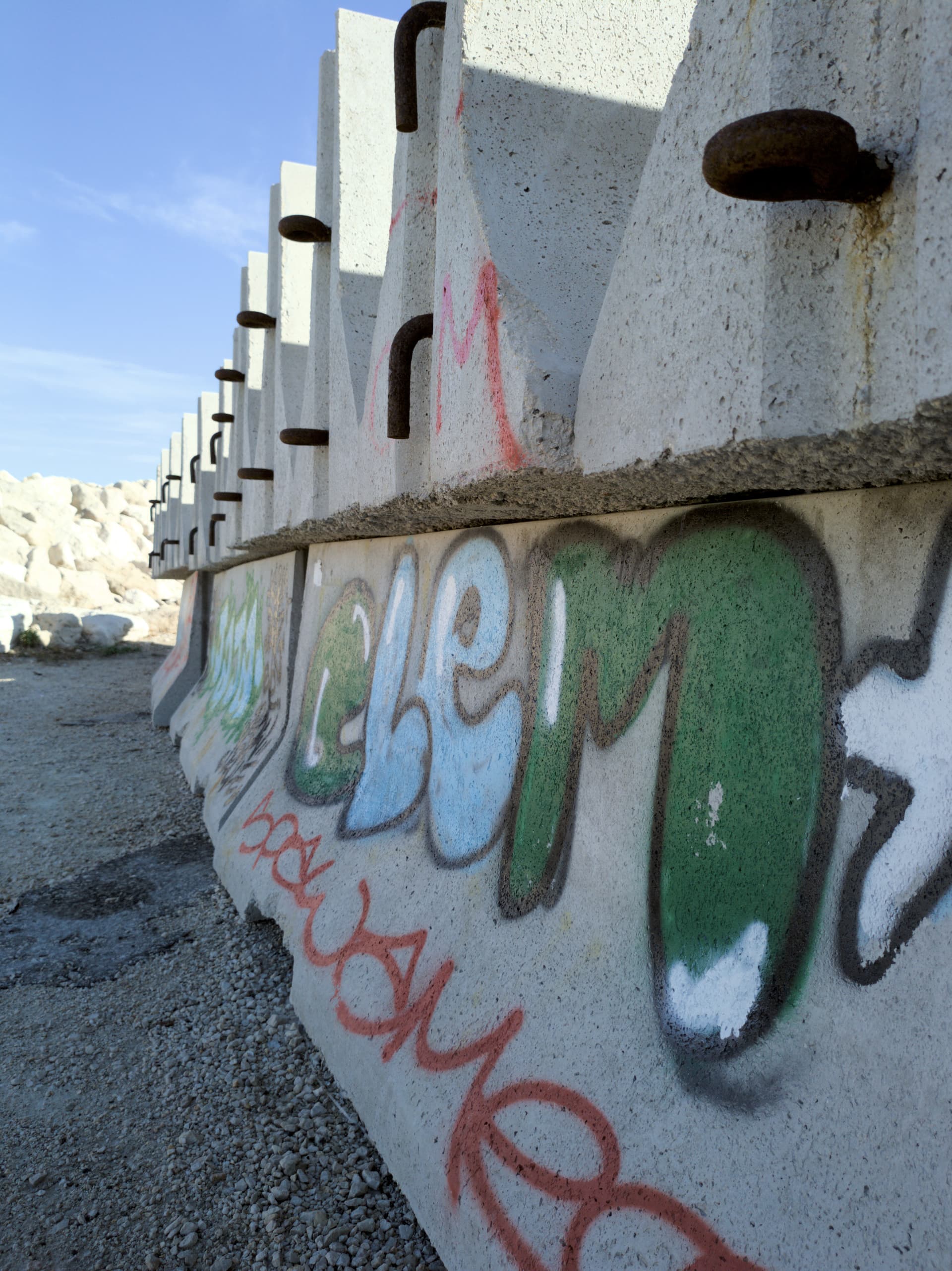

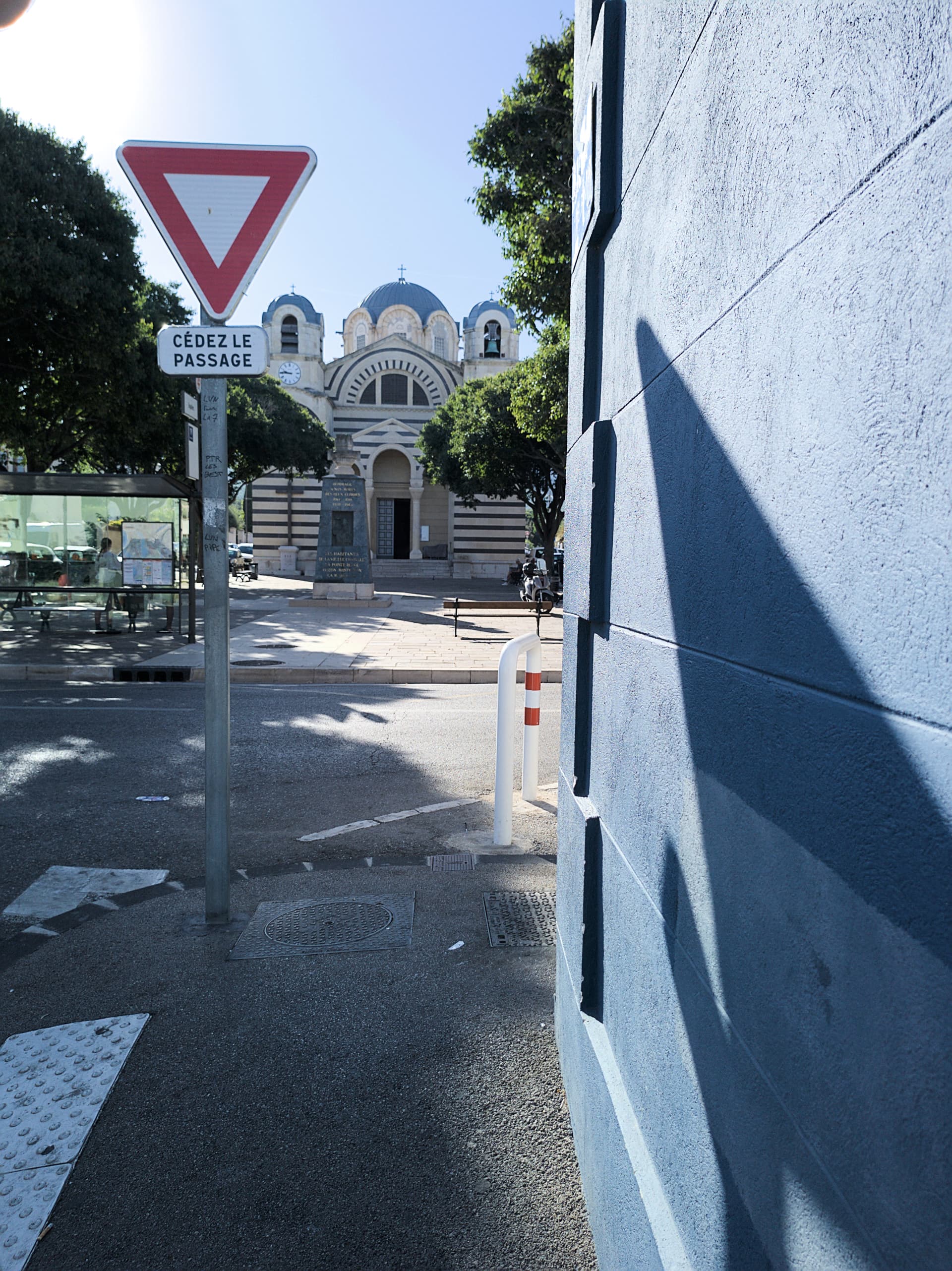

Stock app:
DNG:

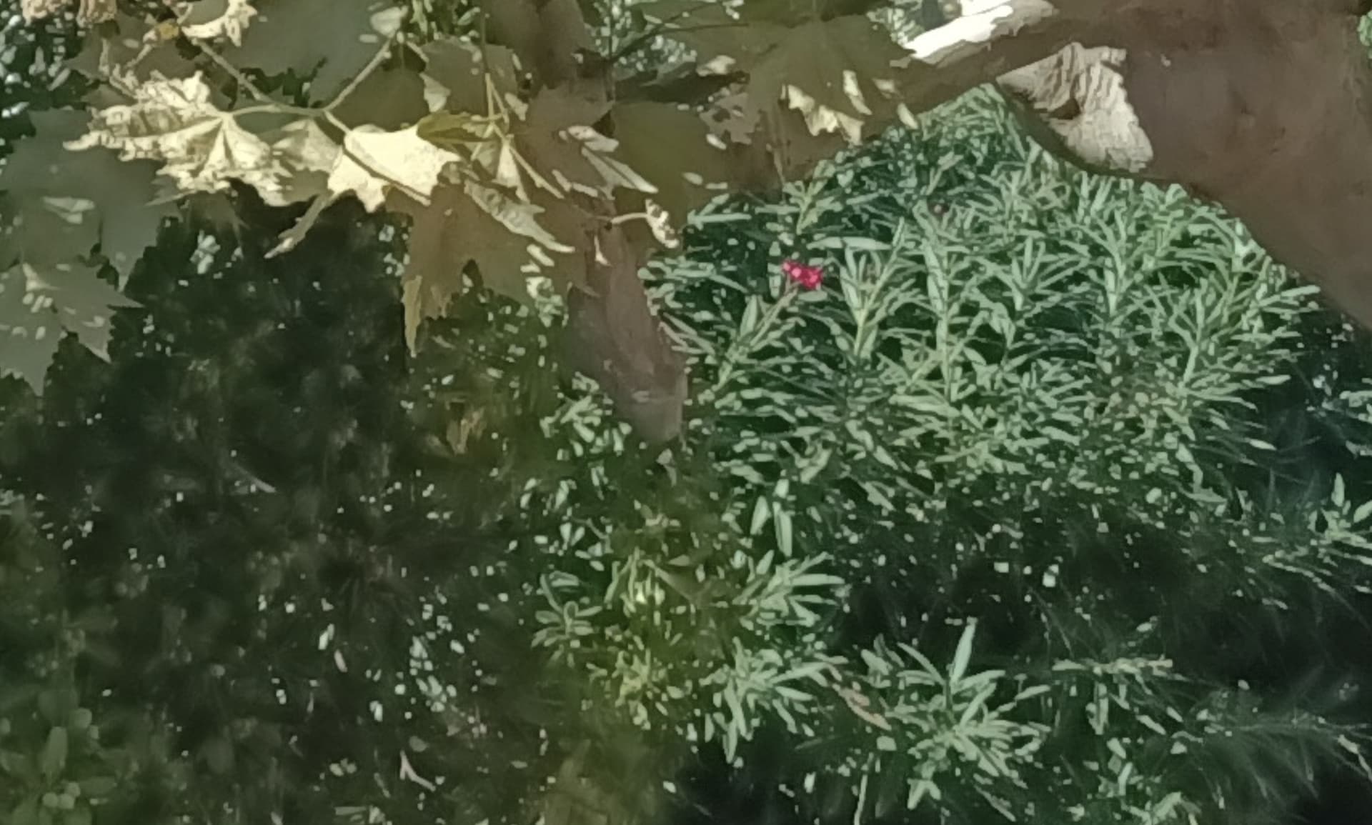

Crops:

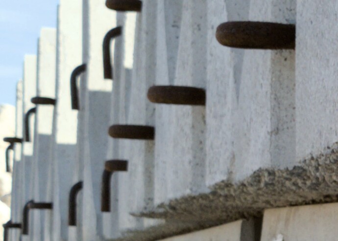

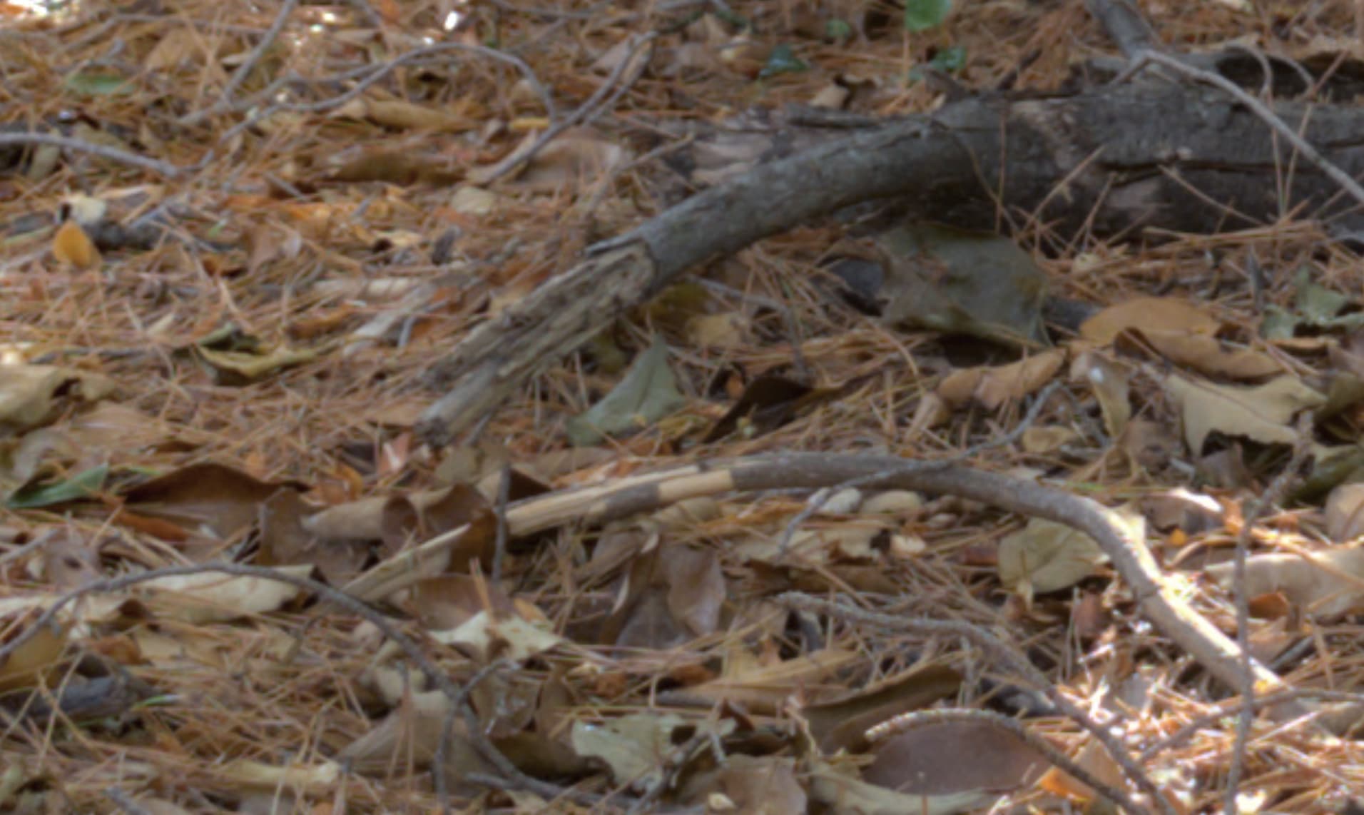

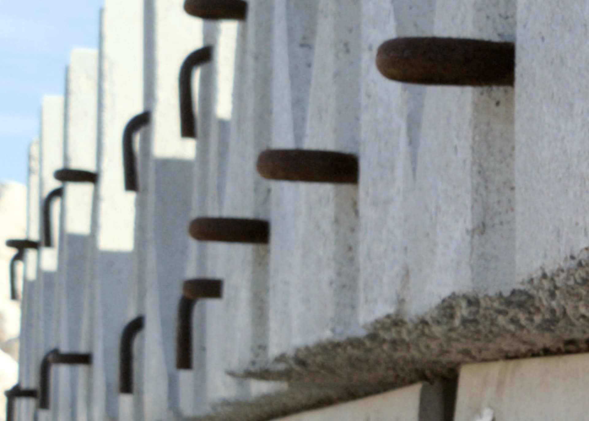

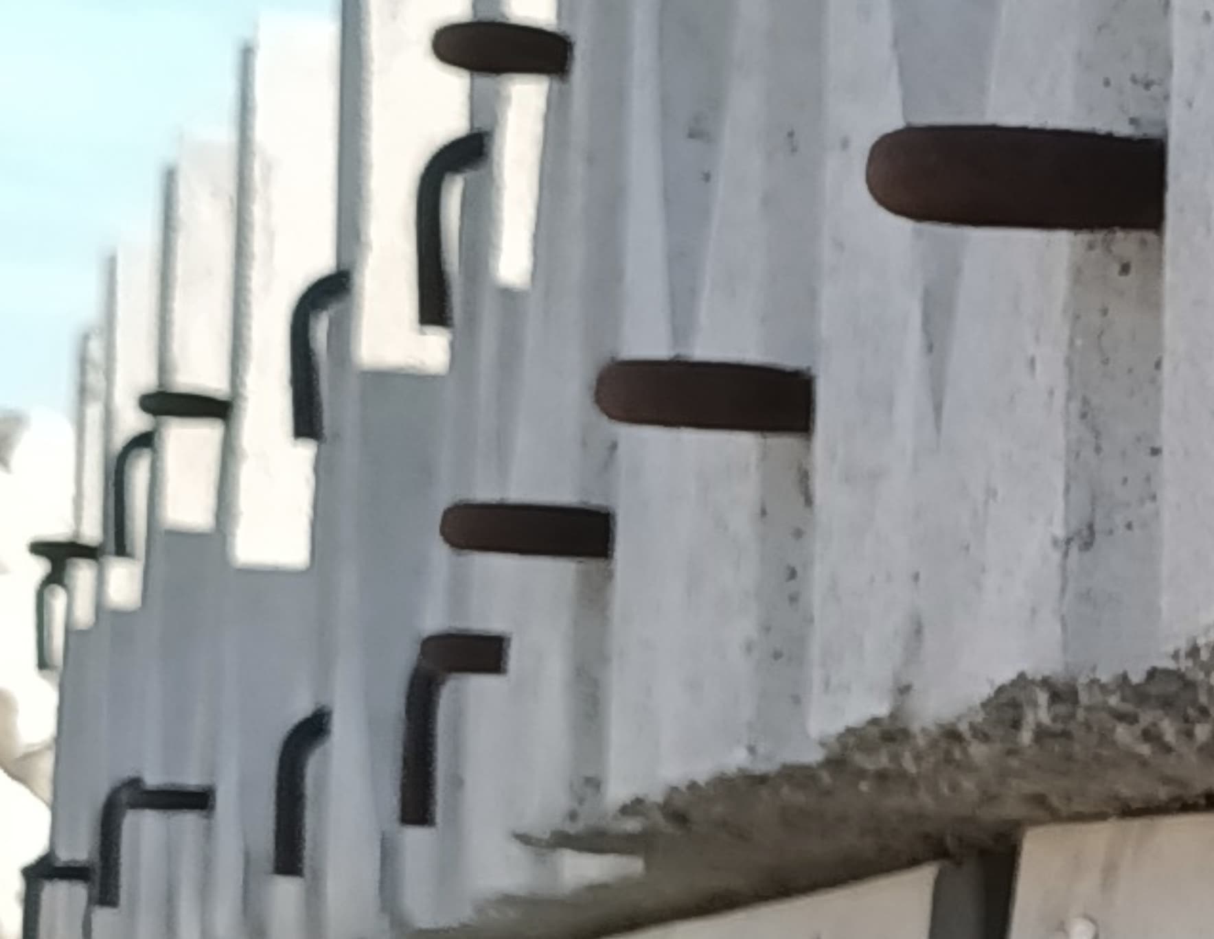

Stock app:
DNG:
See how the gradients on the rusted steel are alive and natural
Also the concrete textures are richer

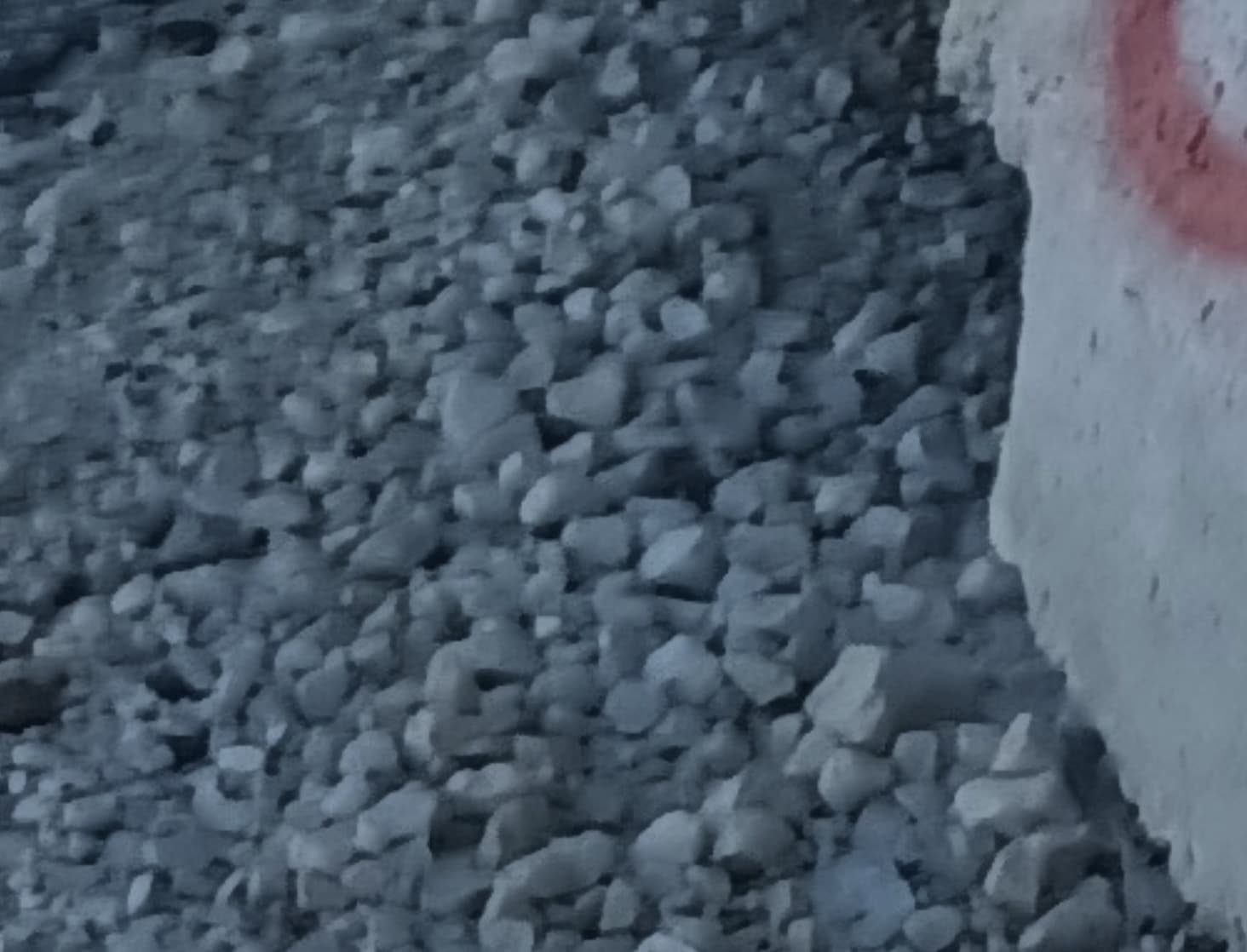

Stock app:
Almost monochromatic gravel
DNG:
More nuances in the tones
More details

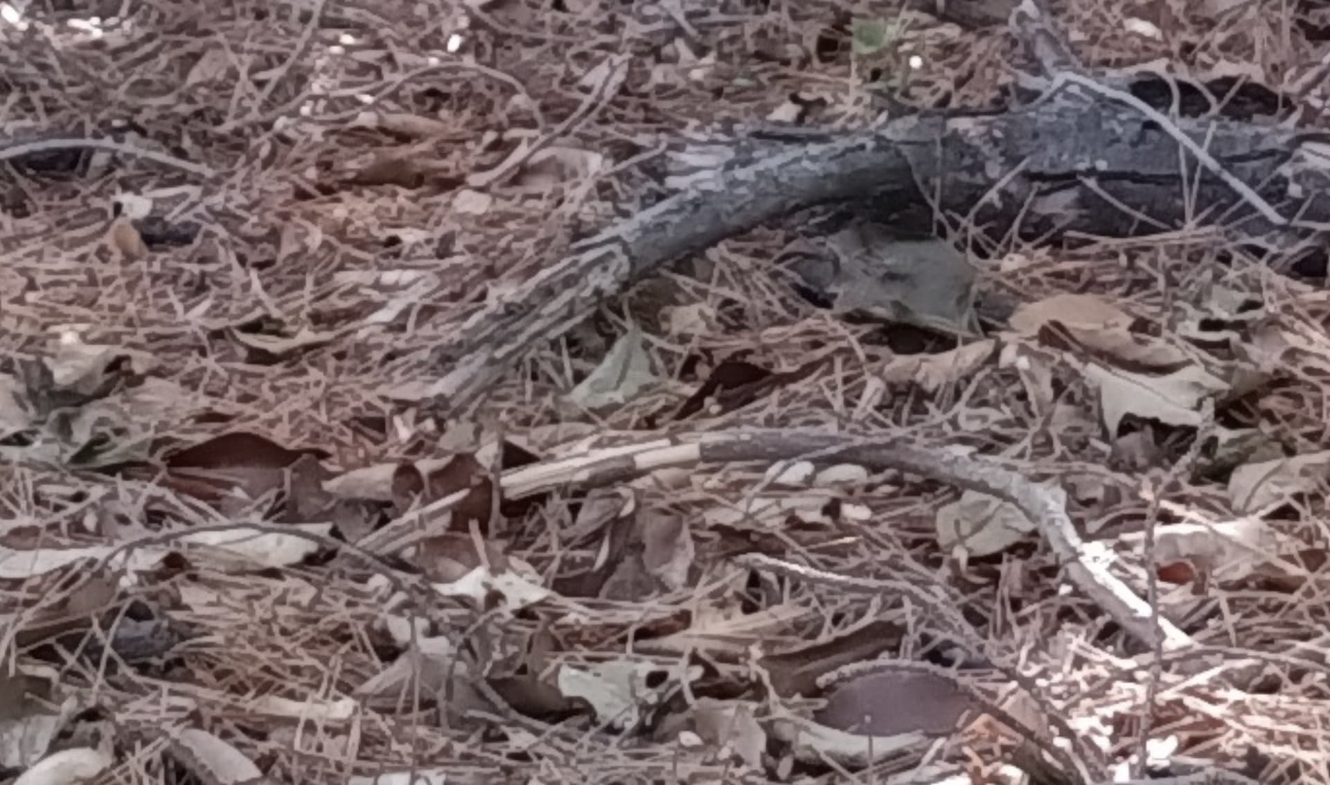

Stock app:
DNG:

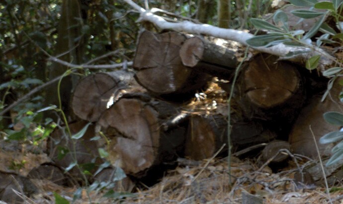

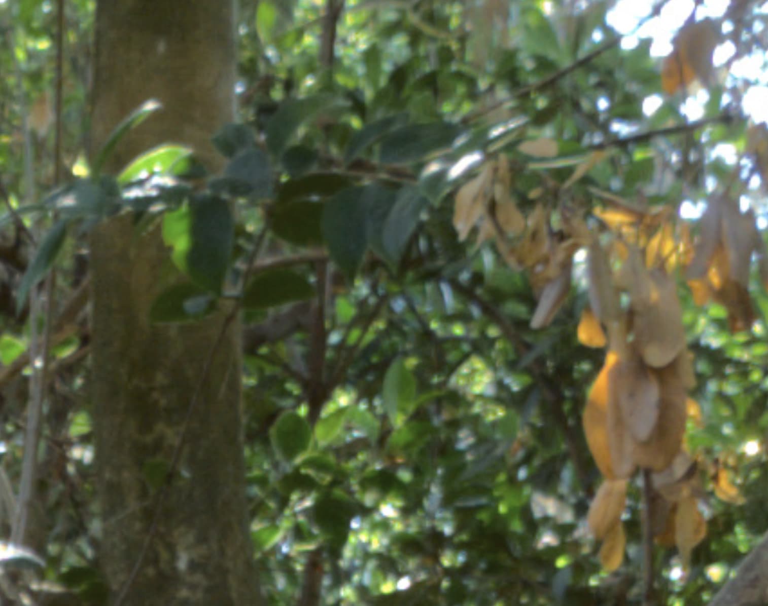

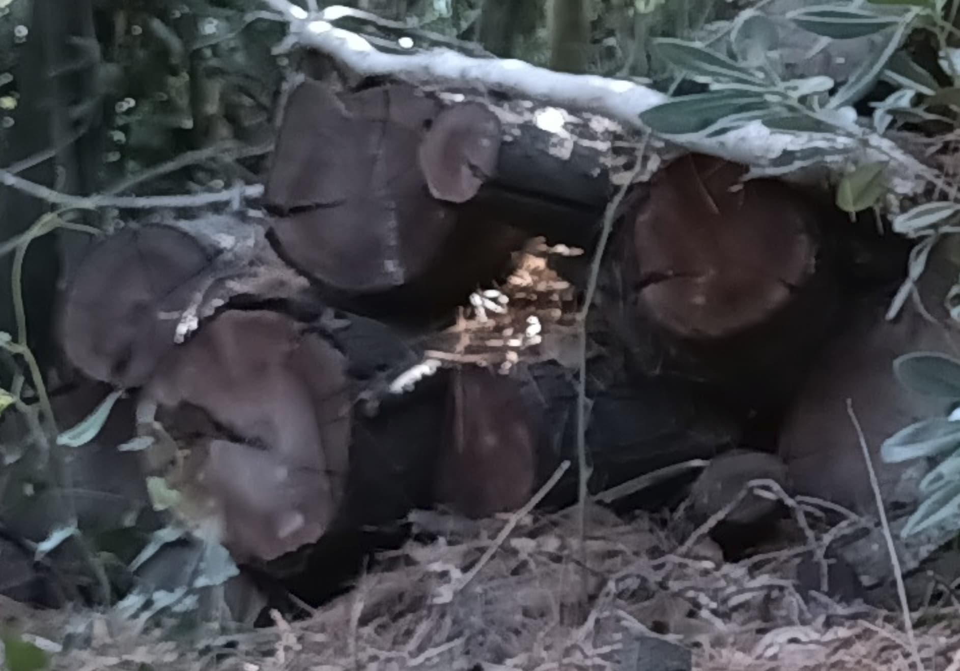

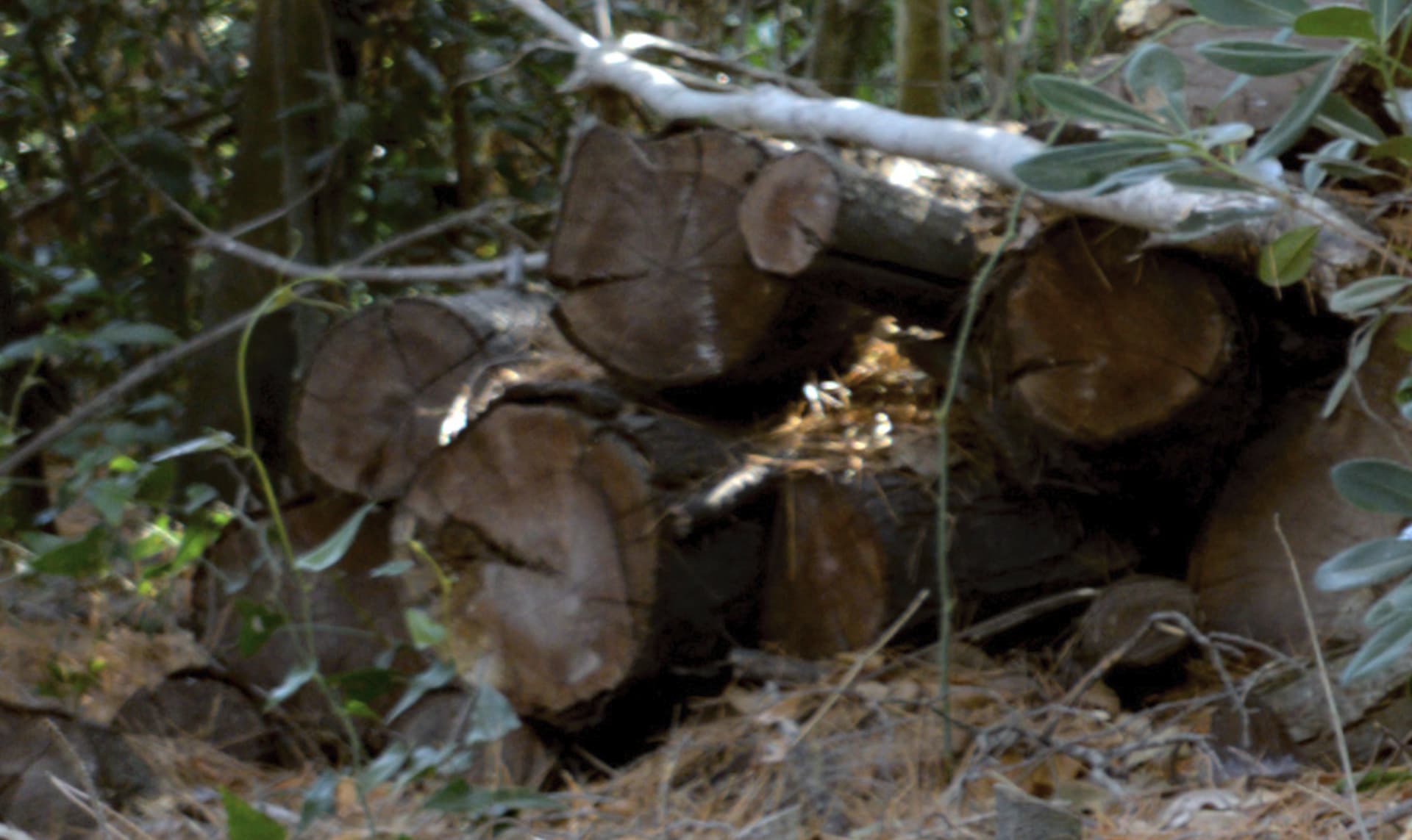

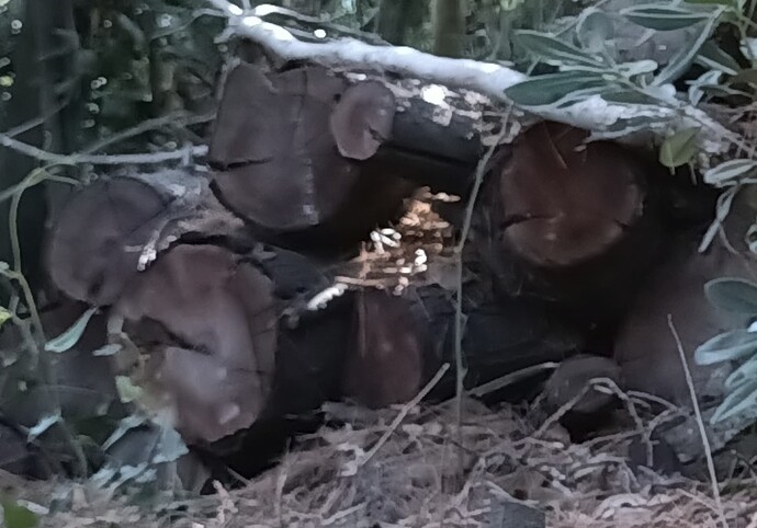

See the wood details, life is back

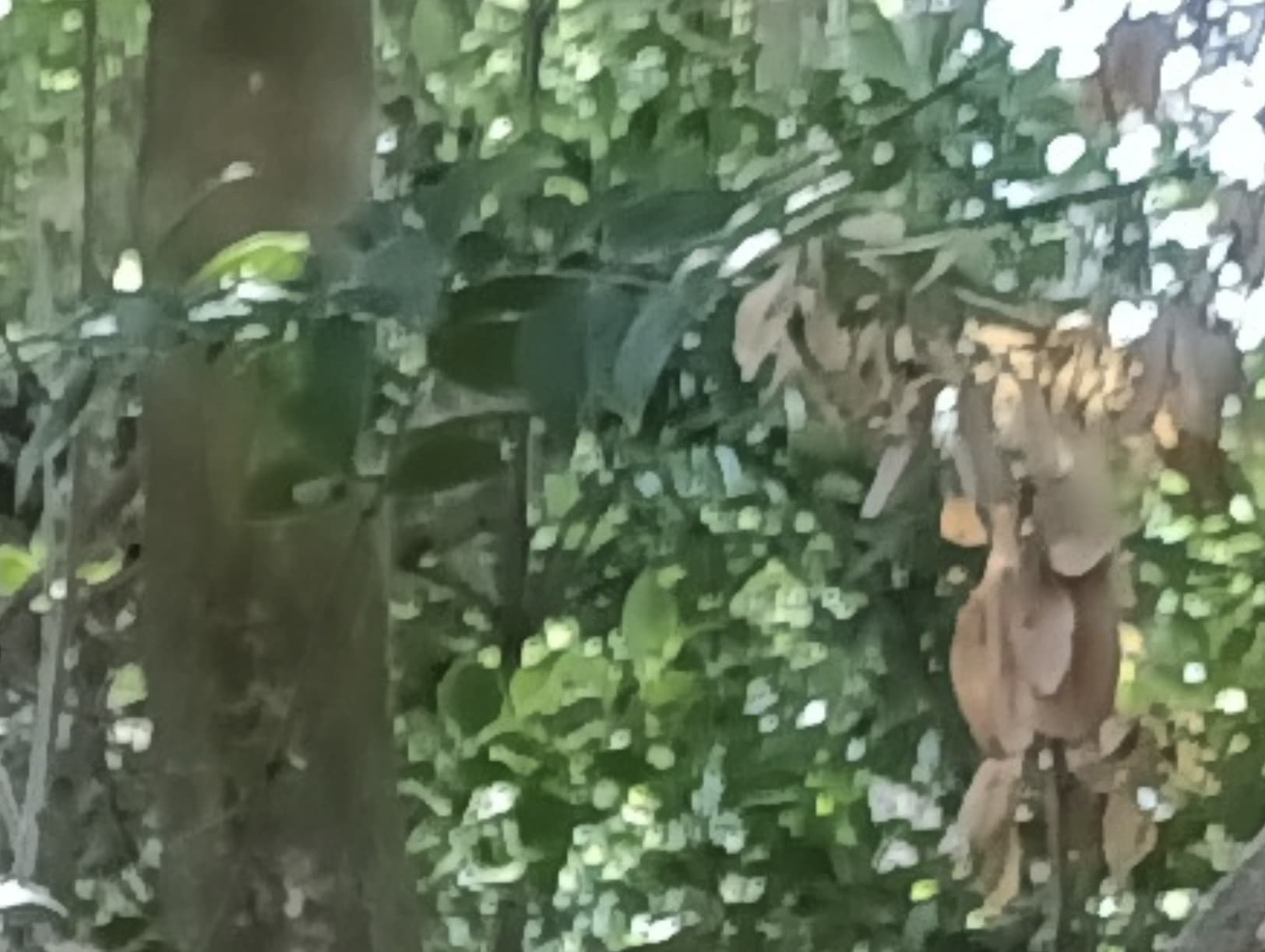

Stock app:
DNG:
Blurry but more of a natural feeling (trunk, leaves, sun)

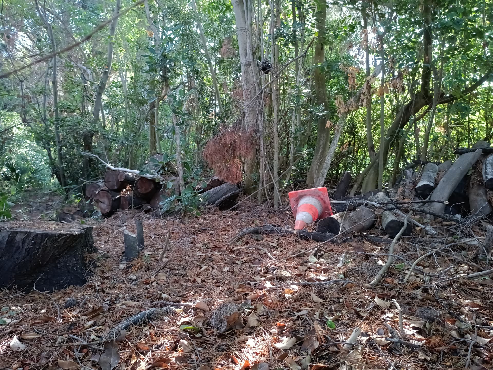

Stock app:
DNG:
Can you smell the forest?
Unfortunately different focus distances. But still…
Stock app:
DNG:

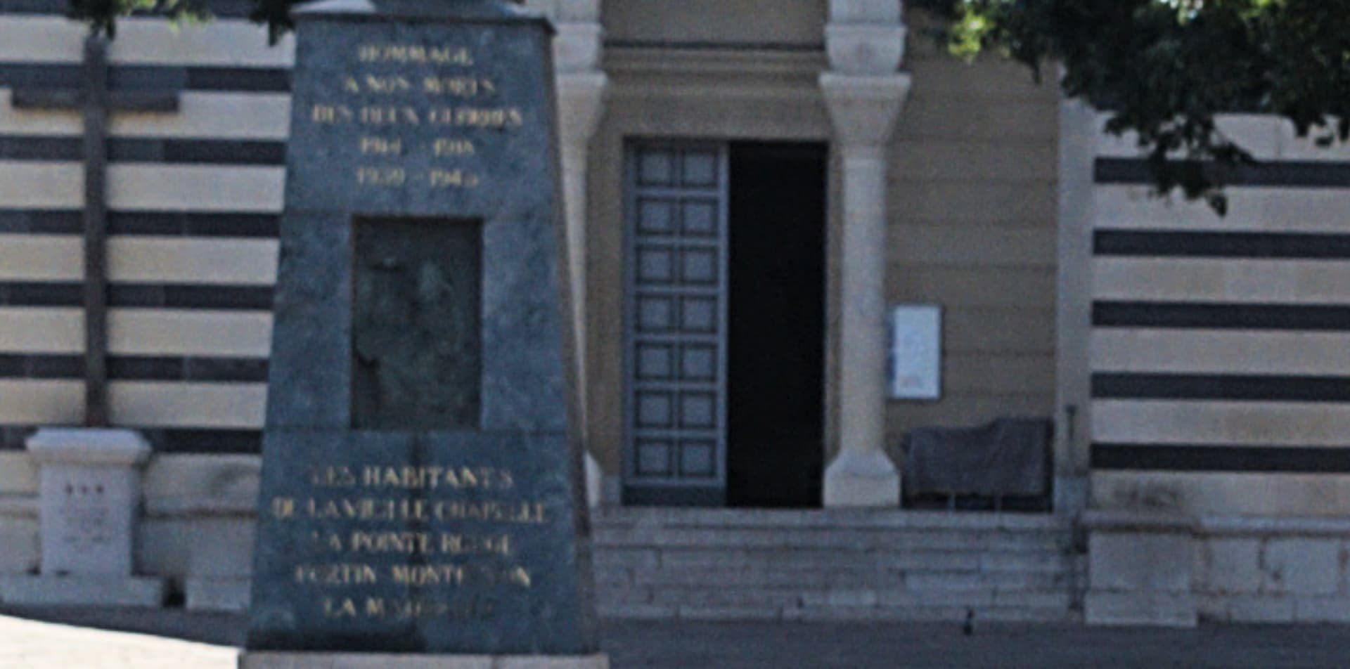

Stock app:
Video game feeling
DNG:
(different focus)
True photo feeling, nice noise, imho.

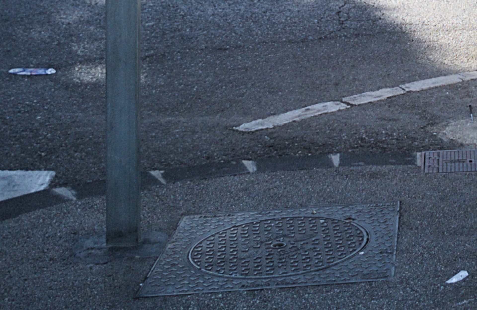

Tar + steel post textures
Stock app:
DNG:
Nice noise.

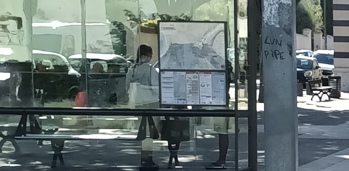

Colors on the bus sign.
Steel post texture.
