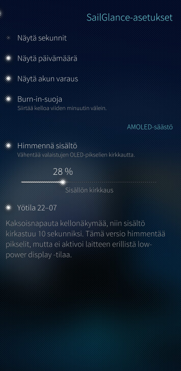

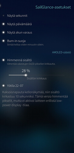

The issue like i mentioined is that it needs way too many system editing and hardware knowledge, so this Glance screen that i also liked on N8 and Lumia 800 should be developed by Jolla team.
Heres just some of low end coding i managed to do but i cant set the backlight to turn off so in dark it has light on all the time compared to Lumia 800 or N9 that you cant see the text in dark only in light.
just to clarify, you and the OP are talking about is more like an LPM glance screen, which is already a feature on sailfish as part of mce and just needs to be enabled as described by the OP. making a glance screen app to wrap those settings is presumably simple, and doesn’t require doing anything in particular. sailfish could include a toggle for it with minimal effort, but they explicitly do not. i always assumed this was because of battery life suspicion, even though it uses surprisingly little battery even if you run it 24h/day
my comment is about how to build a related but different always-on screen, that updates every minute with custom text based on notifications/etc, and never turns off. this is more like what was on later symbian, meego, and windows phone devices. the Nokia N9 had two different apps, by admiral0 and thp, to customize the display.
making an always-on screen ‘app’ would require patching QML files and running several daemons and writing several wrapper scripts. it would be great if jolla could recapture the glory days of the N9 with this feature.
