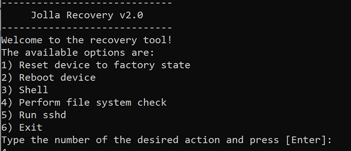

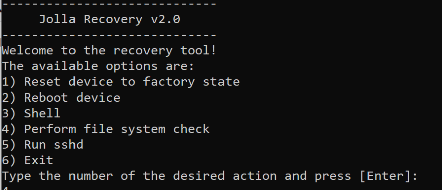

When starting JP26, when the Jolla logo appears, hold the volume up button.
Afterward, three menu items should appear in the middle of the screen:
[Recovery Mode] <<==
[Fastboot Mode]
[Normal Mode]
Use the volume up button to navigate.
Select [Recovery Mode] <<==
Now press and hold the volume down button.
The recovery mode should now start.
Connect the USB cable to your PC/laptop and connect via Telnet to the IP address 10.42.66.66. This should put you in recovery mode, where you can start the SSHD service. After that, you can connect to the IP address 10.42.66.66 via SSH.

Have you tried the file system check (option #4), in case there is something wrong with the filesystem that prevents the boot?

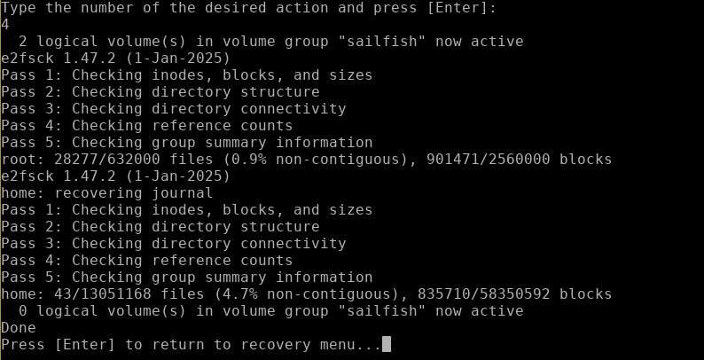

Yes, I performed a file-system check.
It ran without errors.
