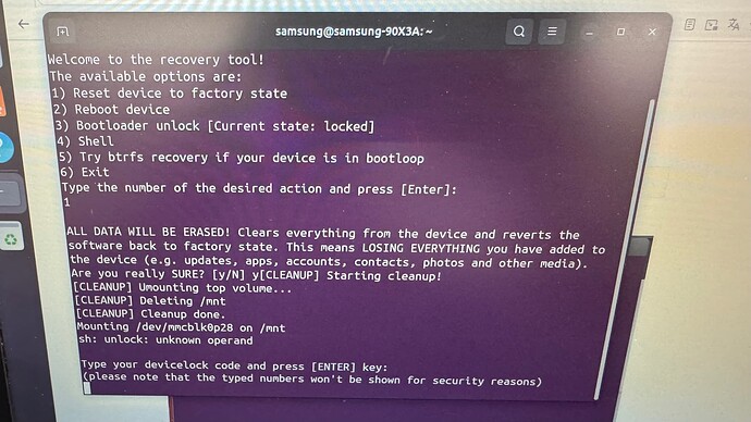

Jolla-1 - Booting and Screen only Jolla and shutdown
The phone only shows Jolla and if you connect the charger, the phone boots and the charging icon appears when on the charger and looping it. If you remove it from the charger, it wakes up but only Jolla appears on the screen and the phone turns off.
I can enter it with the terminal in ubuntu and it shows Jolla Recovery v.0.3.1 menu
Bootloader Locked and btrfs does not help.
If i want to reset it from terminal menu in ubuntu do something and finally ask for the DeviceLock code.
The device went into this state when i reset the phone to the initial settings from the menu. (previous owner had reset this also).
Was there a solution to even get the device to basic mode :slight_smile:
The memory card is connected where it has a “shell” but to activate it from terminal this phone want the devicelock.
Original user says no devicelock code inside.
Jolla-1 works fine before the “factory reset”. It was original state but no any programs inside.
JSOS is Kaajanlampi 1.0.0.5

there is no devicelock and no screen lock. When i connect to ubuntu terminal it needs devicelock

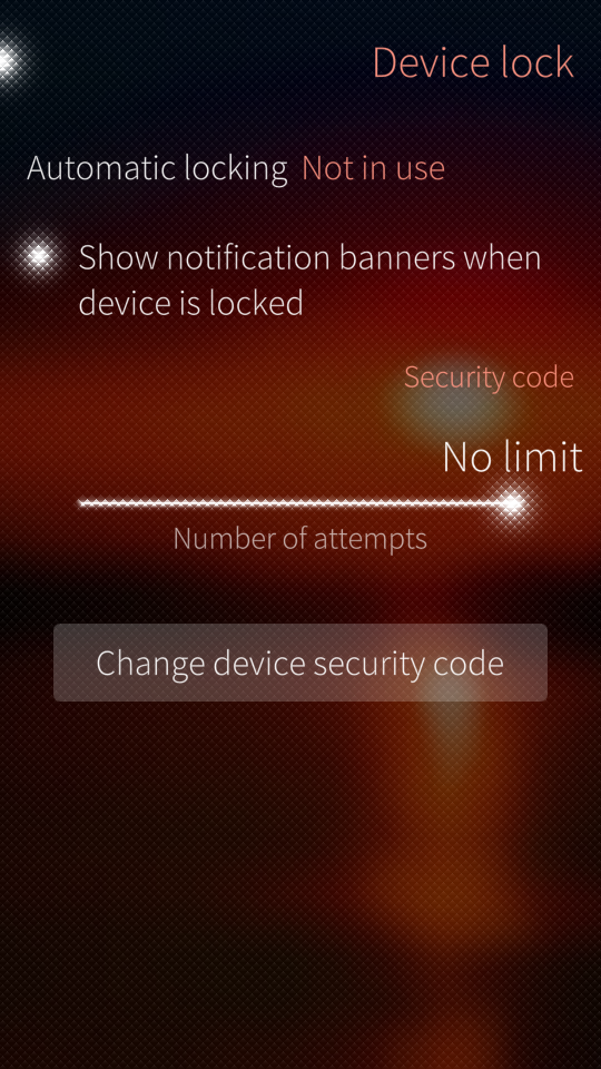

May be too late, but did you check no password is needed when you try to change the security code. I have a different software version in use (Pallas-Yllästunturi 3.4.0.25) and there seems that you have to set a 5 digit code for security. That could have been a case with older versions too. Attached is the screenshot.
Have you read through: https://jolla.zendesk.com/hc/en-us/articles/204709607-Jolla-Phone-How-to-use-Recovery-Mode#4 and take a look at the PDF attached. That shows expected output. The devicelock code is your PIN for the device. It has been very long, but wasn’t the original code 0000?
i read and understand that link how to
i think that the previous owner of phone not remenber or not know the devicelock code. Maybe put allready when bought phone from dna operator
when we put the phone hard reset from menu there is no warning that back to life not work anymore. Ordinary phone ask the pin code when make hard reset to os but if Jolla OS not ask this is possibility then.
