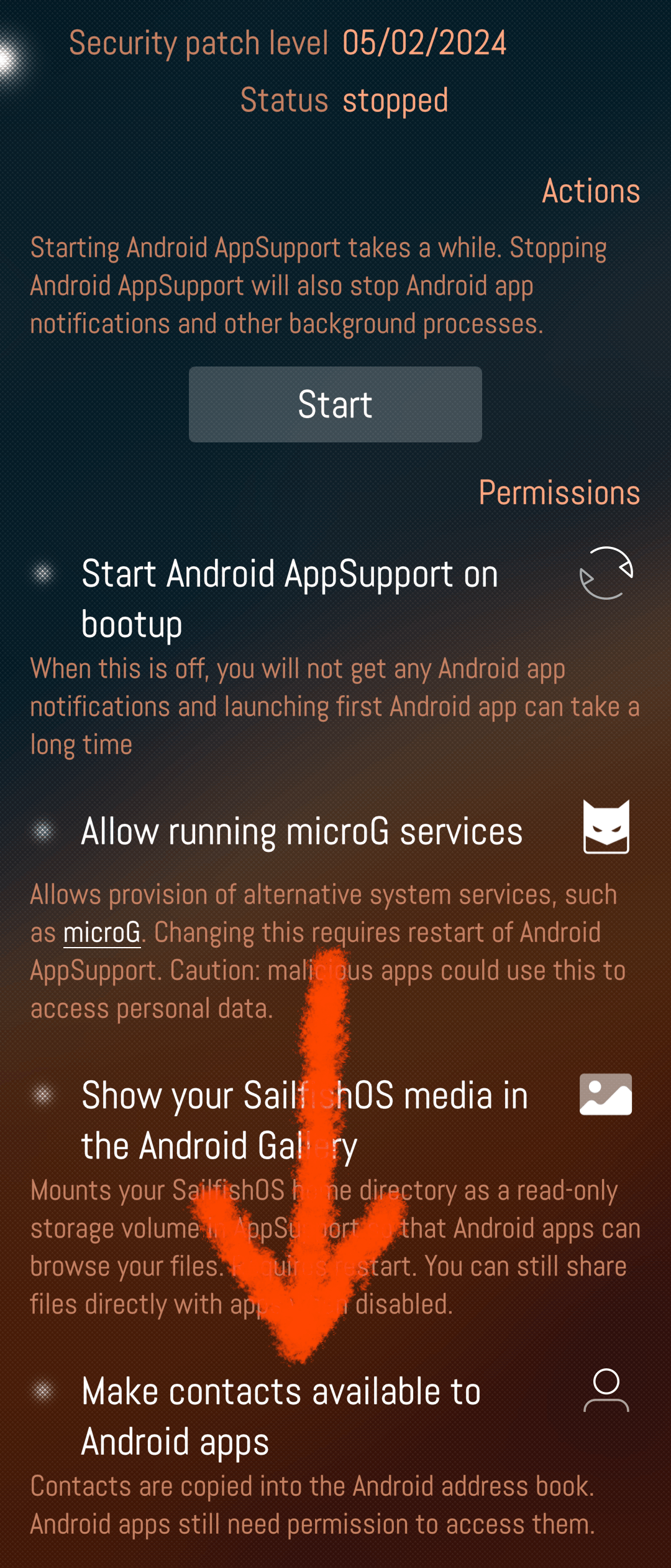

Have you enabled this:
Also are you sure it couldn’t be your firewall?

Yes.
It’s not that because I tried this months & months ago (well before I tried firewalling Android apps), but I didn’t get around to mentioning it until now.
