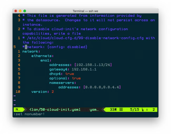

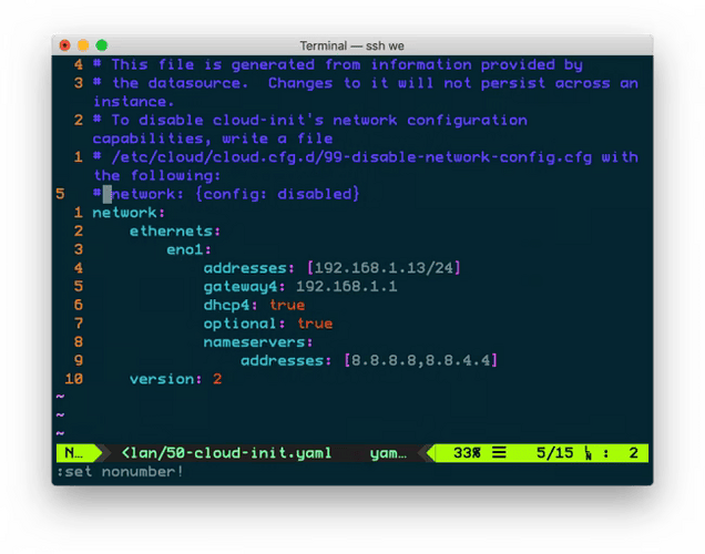

Another way to set a static ip address is by defining it in the client.
There is a risk in a more ‘normal’ network of ip addresses being duplicated if the router provisions the same ip as defined by another client, but you should be ok.
In your case I would make a note of your phone ip (from the Developer tools section of Settings) and use that. I would also do the same on your computer and as many devices as possible in order to avoid the possibility of duplication.
I haven’t done this on a linux system (years ago I used to set static ips on my Windows devices, but since then I’ve used the router where required), but I assume something like this might work:
