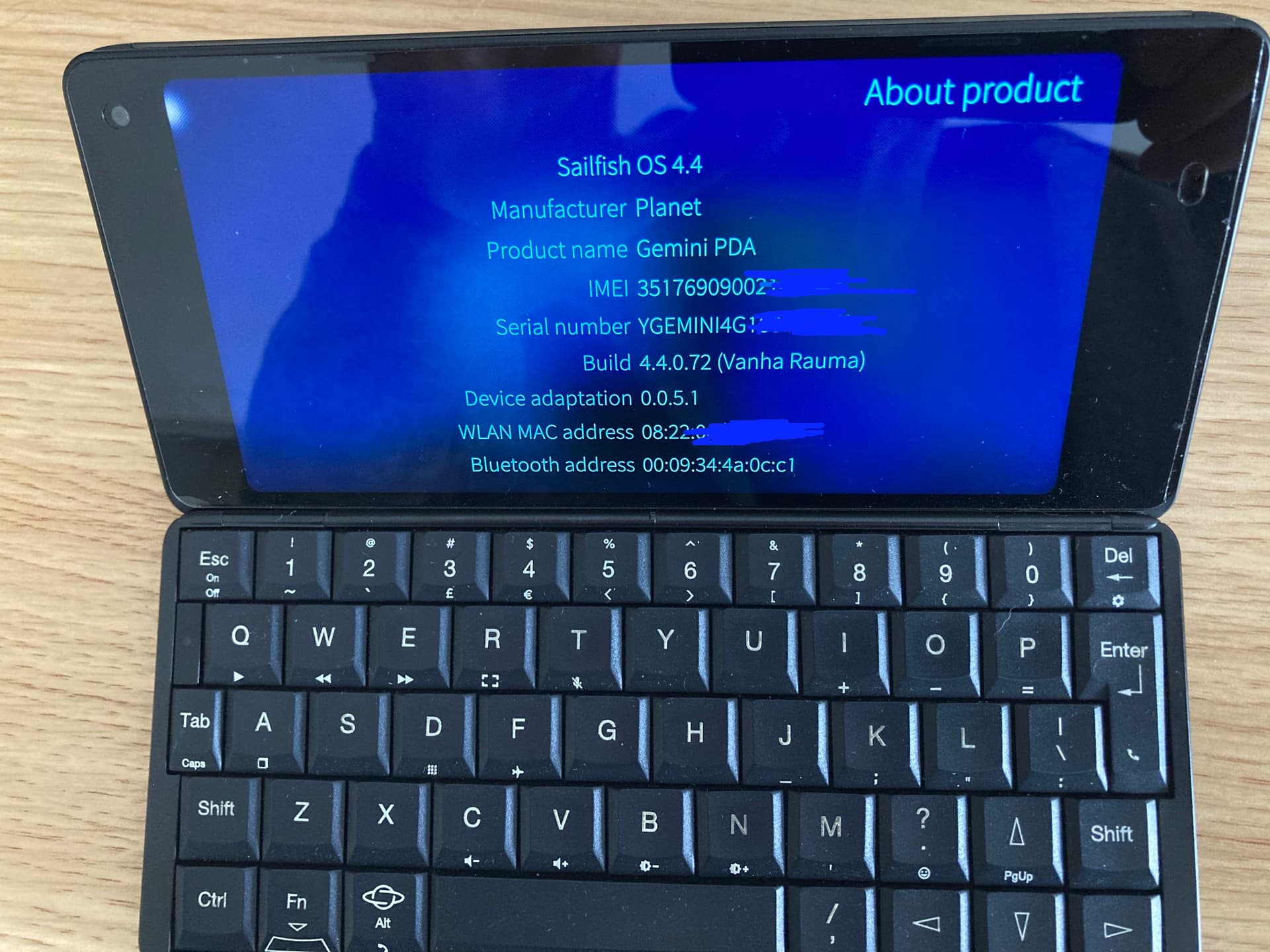

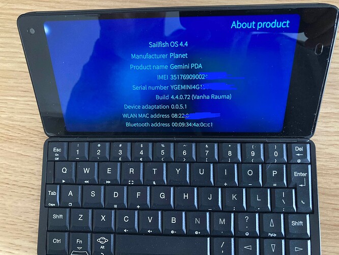

Sailfish working with the shared image. Thanks. Just can’t get to flash imei back
Glad that part worked for you, managed to update mine to last version. Sorry no first hand experience to advise you further with this issue unfortunately.
Sadly can’t update without imei. Is giving an error about imei

After a several shots managed to write imei back with maui meta v10.1816.0.1
Good job, hope it encourages others to try. :grinning:
Hope so and i will gladly help anyone that needs
