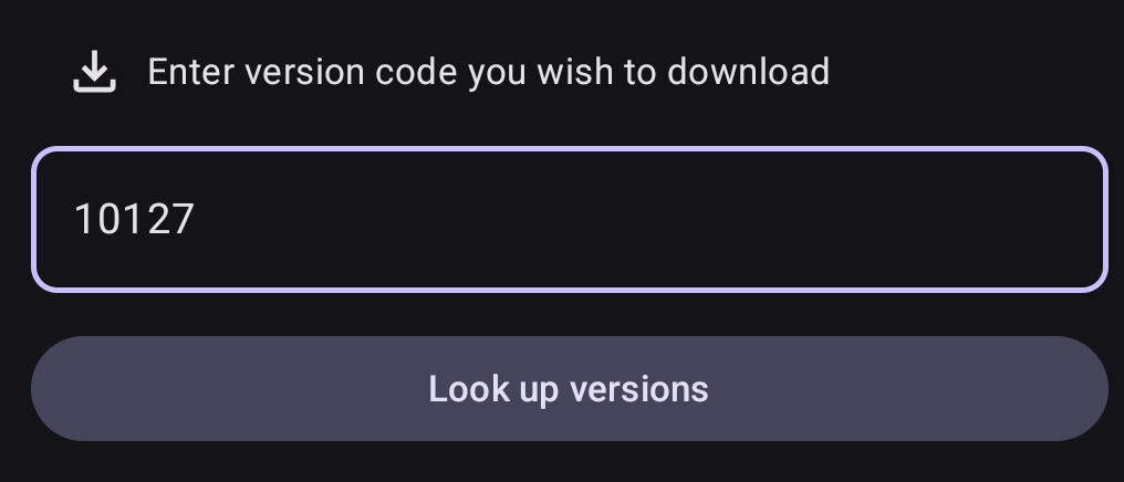

En löydä aurora kaupasta muuta versiota kuin v85.0.1 (10127)
MOD EDIT DEEPL TRANSLATION: I can’t find any other version of Aurora in the store other than v85.0.1 (10127)

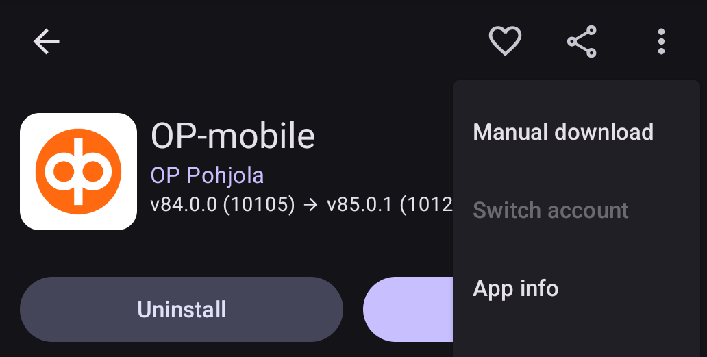

You can select to download different versions from the Aurorastore, application “…” menu.
Eli toimivan version saa ladattua pistevalikosta.
