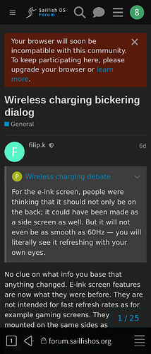

The Jolla browser wotks but I get a message that the jolla browser will stop working on the jolla site… thst is notba good look. Anyone know whsts going 0n?
It is a bit outdated but there will be an update of the engine with next os version 5.2

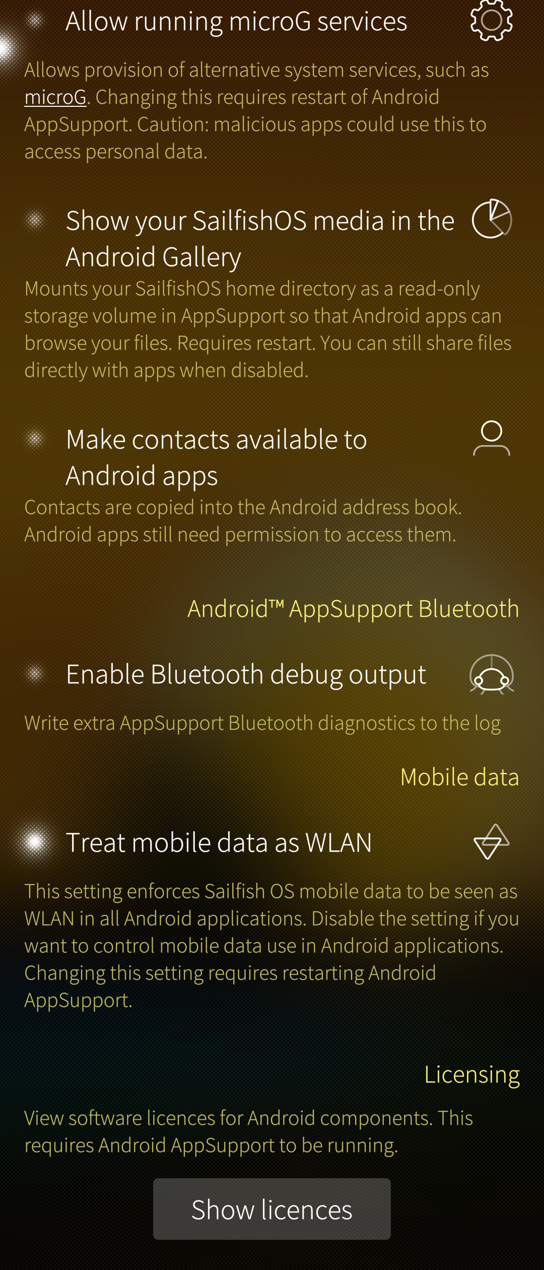

Just wanted to add to this…. I checked the Appsupport settings and I see a lot of options… but no matter what I do or change, Android apps no longer work with mobile data on the Xperia 10 IIII.
If I connect to WIFI the apps work fine but if I don’t have wifi and have to use mobile data. The Android apps will not connect to the internet.
