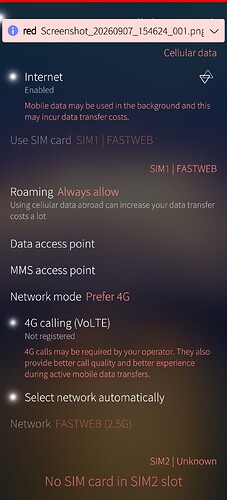

The same SIM can only get 2G or 2.5G signal on my Jolla Phone, I tried both Automatic and Manual network selection.
I also can’t get mobile internet connection.

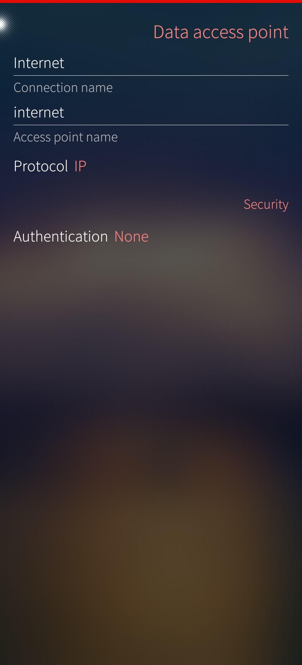

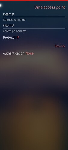

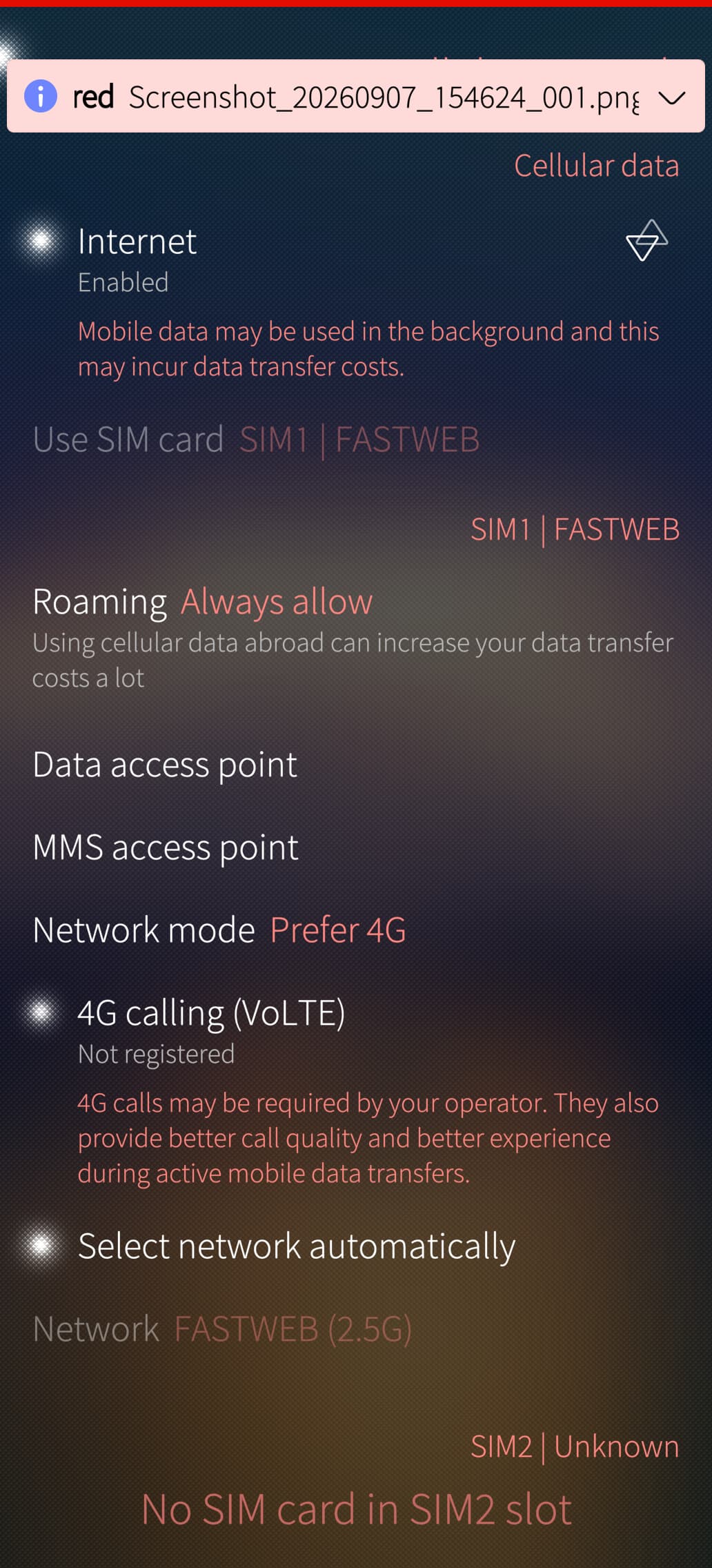

Adding some screenshots of the issue, hoping they could help someone diagnose the issue, maybe my access point is wrong? I’m desperate :smiling_face_with_tear:
Also tried Automatic, no changes

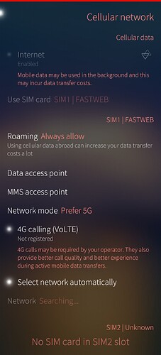

Sometimes the network goes away completely and with cellular data active I’ll be prompted to select a SIM for the mobile network. I select my SIM and nothing changes.
Do let me know if anyone has any idea about tests I could run to find out the problem!
The access point is definitely wrong - it’s what gets filled in by default if your provider isn’t in the database, but it’s non-functional because it doesn’t point to a server.
Looking at the Fastweb website, the connection name should be ‘FW WEB’ and the access point name should be ‘apn.fastweb.it’. Have a look if that fixes it.

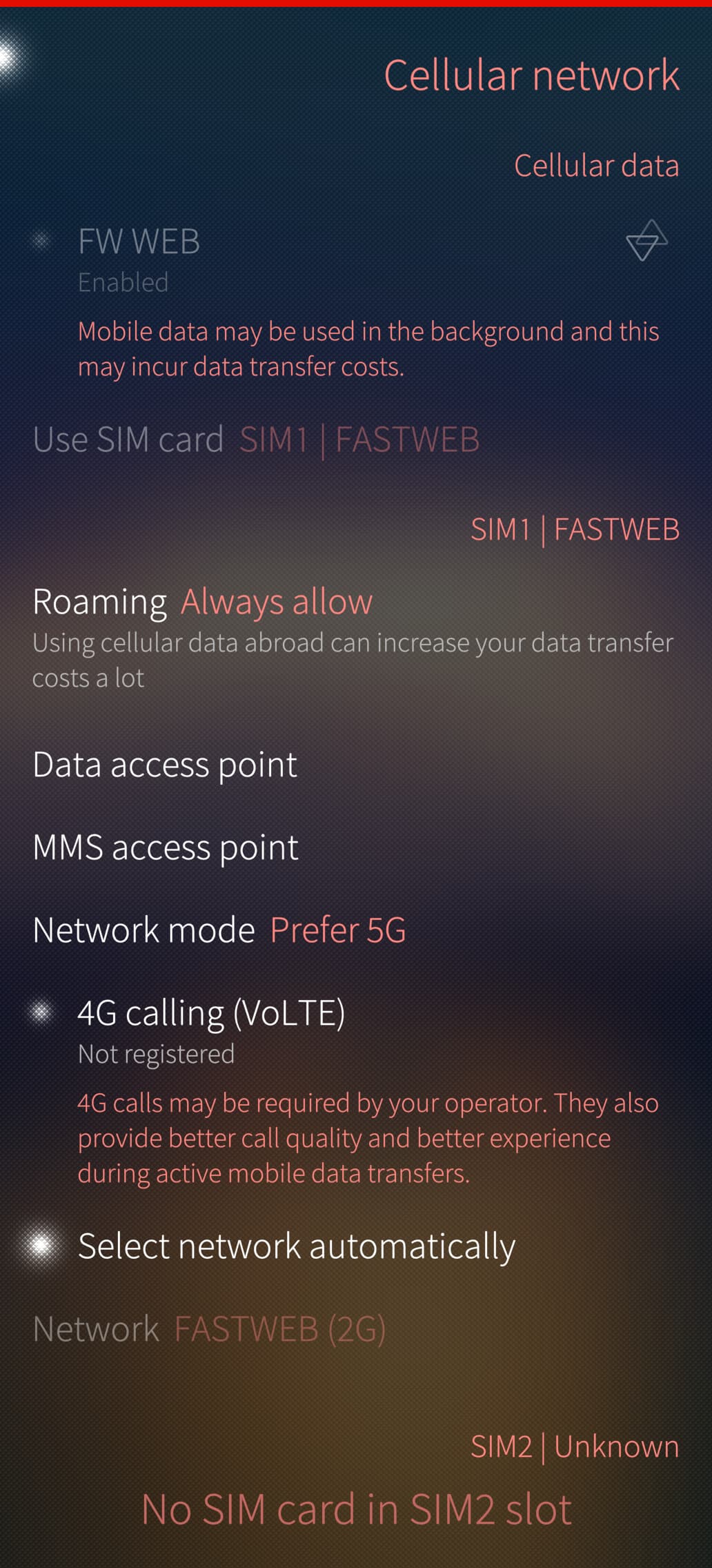

I tried setting those values and tested some more, unfortunately it doesn’t seem to make a difference
Also tested Prefer 4g and all manually selectable networks
