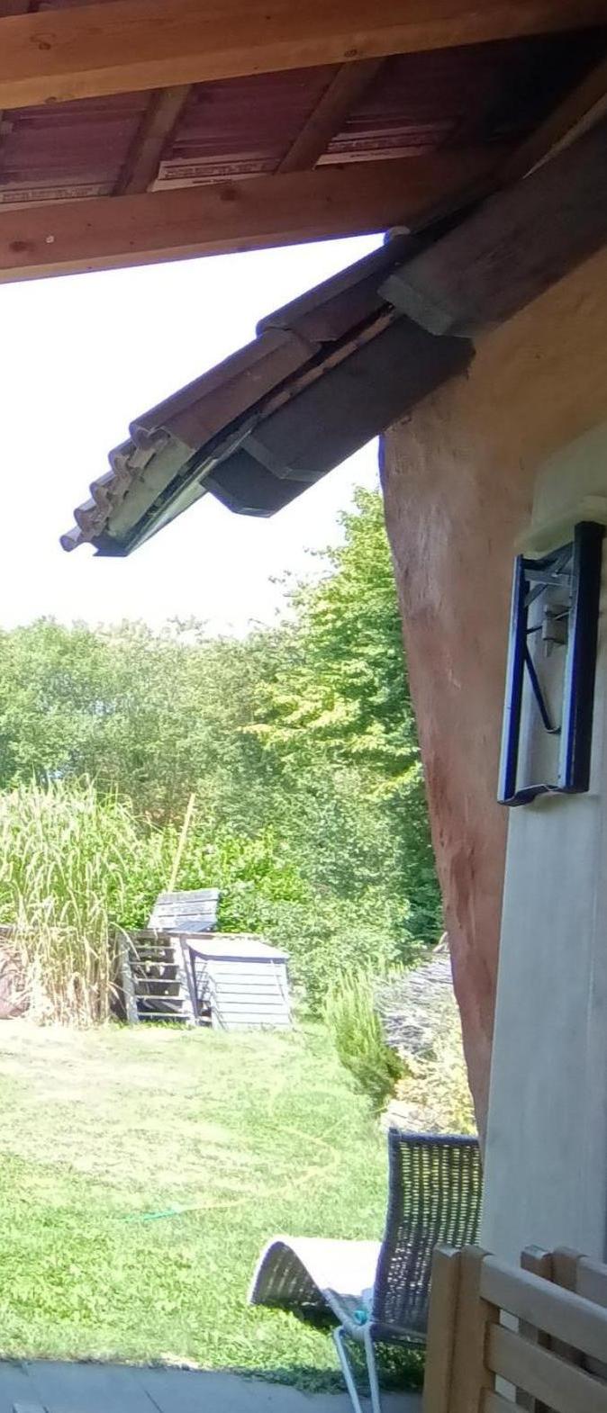

  1. The colours of photos show massive differences. Photos taken with the 0.5 camera have bright colours and are okay, photos taken with the 1.0 camera are less bright and miss brilliant colours.

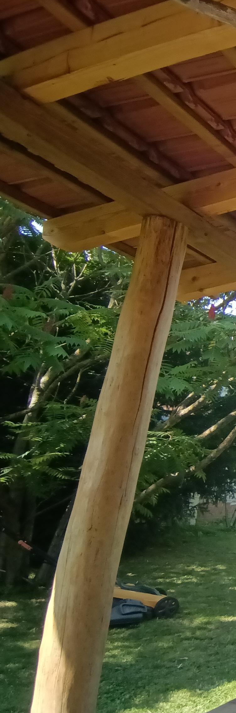

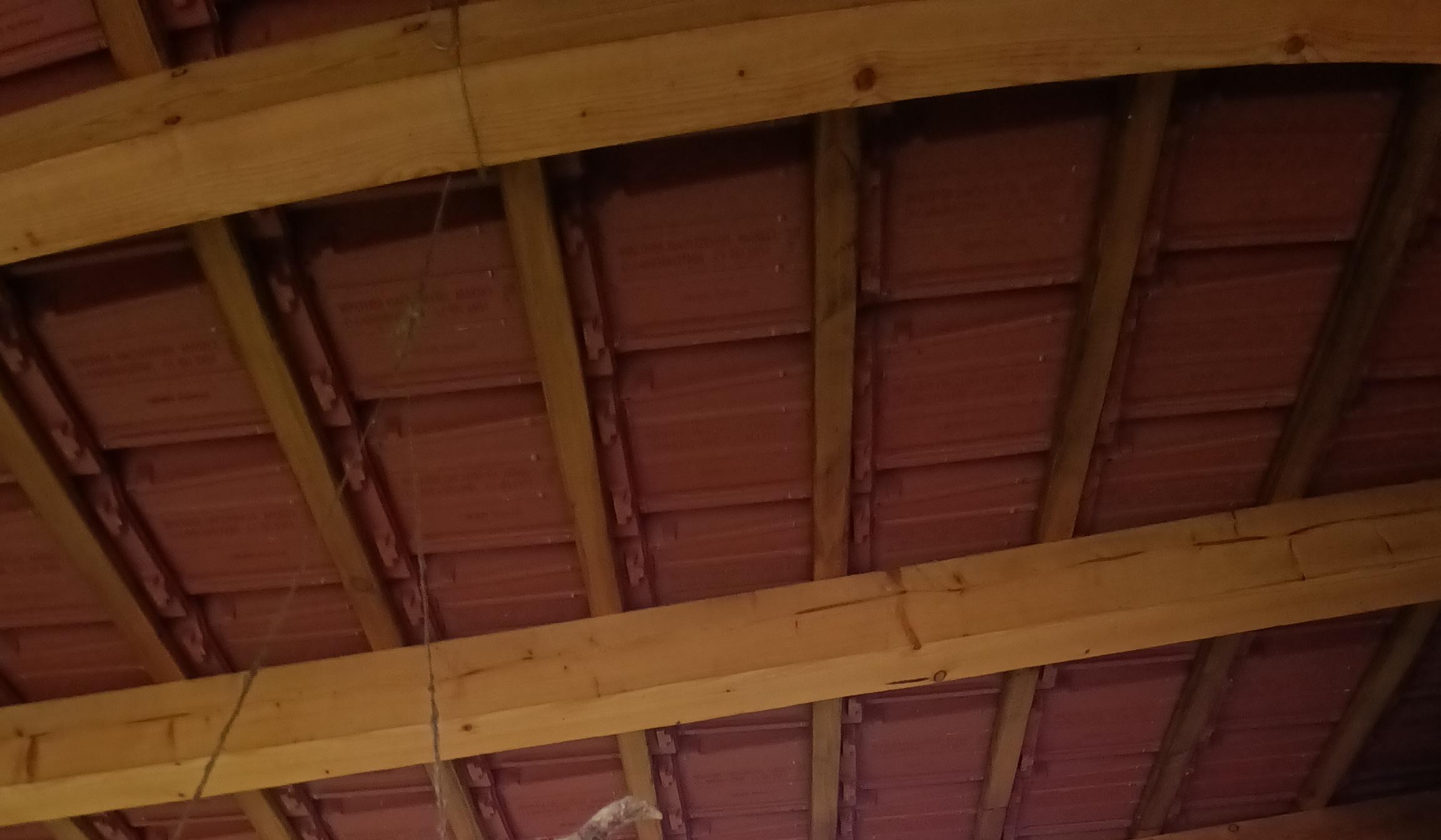

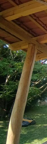

  2. The 0.5 camera causes some kind of fish-eye effect at the top (in vertical orientation, in landscape mode on the left side). Lines that are straight in real life view are bend and slightly rounded. Vertical lines are tilted.

“Problems” 1.) and 2.) you are facing are due to lack of image post processing. More mature mobile phone manufacturers are doing image post processing to minimize differences between lenses (color/exposure- wise) and to “straighten” (I’m missing a better word for this) fisheye effect of ultrawide lens.
You can also consider this as a feature - you are getting all of the visual information from ultrawide lens, which looks a bit distorted, however if the image was post-processed it would have been cropped to fit into rectangular image ratio.

But that fisheye effect is just there on the new Jolla Phone, I had nothing similar on previous SFOS phones - and I used the patch for all three cameras on 10 III. So if it’s a software thing why does it juat affect the new Jolla Phone, or is it related to camera drivers?
I have this exact same effect on my Xperia 10 II, maybe not that noticable but it is there. It also depends on the type of lens used and if there is already some HW level cropping/correction done (which is related to the sensor and driver used). It IS possible this is HW issue but I have seen this so many times on custom ROMs for android phones so at this point I just expect to see this distortion on everything that is community driver (or from smaller companies that don’t have budget to implement this)

Look closer (literally).
