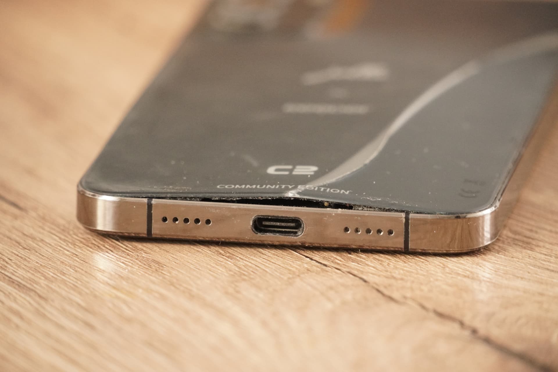

Edit 2026-09-01: WHen taking the device out of the protective case I noticed the battery had swollen noticable for the first time.
The opening appeared to be a good starting point to carefully pry off the (broken) backpanel. Later I found a youtube that also showed that, and the further teardown (of a Reeder S19 Max Pro) that would enable replacing the battery.
Since Jolla is advertising right for repair of the new phone, I asked them if they can send me a replacement battery for my C2 and possibly an unbroken backpanel (with mounting tape) so I can replace it myself.

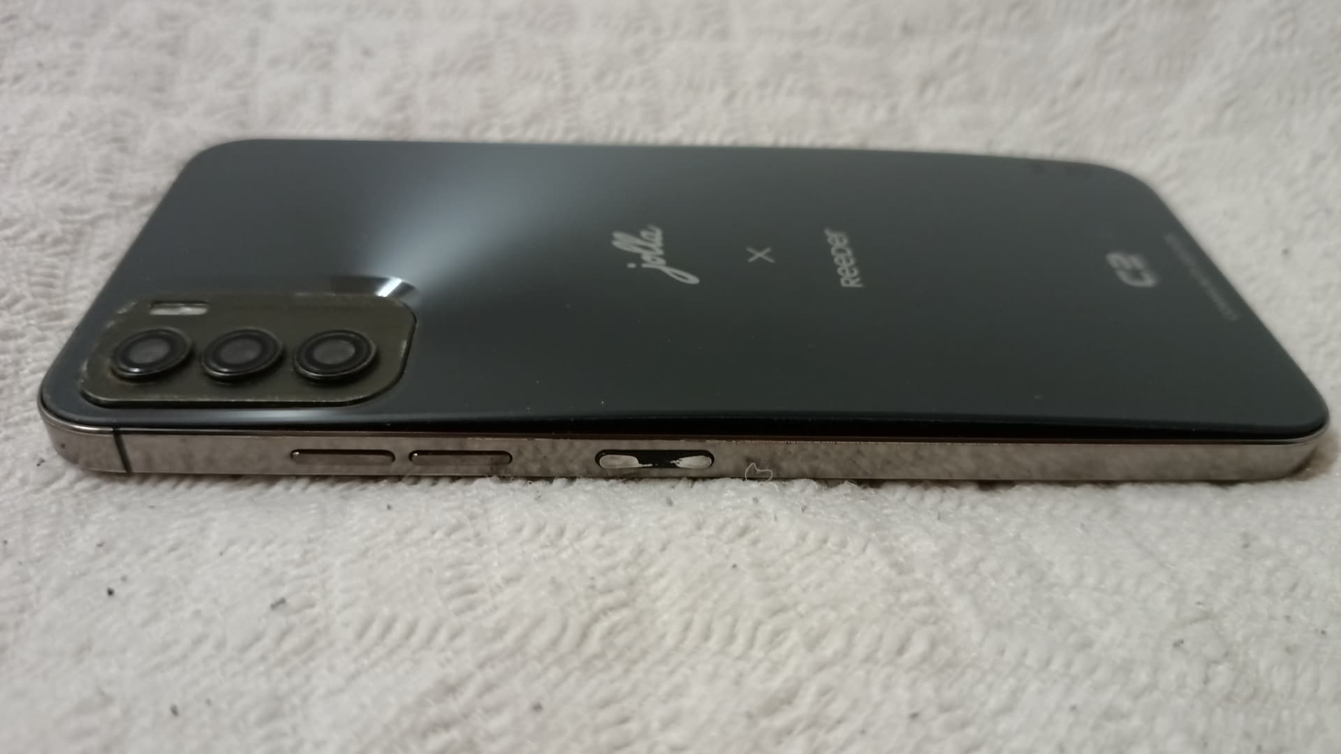

Hello. Have not touched C2 since I got my JP2 1.batch. It’s been waiting in drawer to get some response from zendesk. Still nothing after half a year. Seeing that swollen battery, decided to take a look. And whole long side of back cover is open. So it’s game over. Spare battery would be nice indeed, since looks like not going to get any warranty repair.
