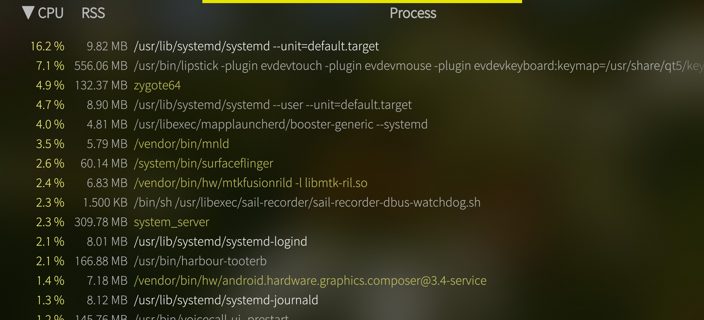

I’ve noticed similar issues, in fact I wrote about this already in my first impressions just after a couple of days usage. Sometimes idle battery drain is horrible and other times very good on the JP2601. I have been monitoring the battery drain the past weeks, and on the best night it drained 2% during the whole night. The worst night thus far, with the same settings and patches and everything as the 2% example, the battery drained 16%. No AAS. The only things active have been rotation lock, Wi‑Fi, and VPN each and every night.
What seems to be happening (for me at least) is that the system starts draining more and more until I turn the device off and then turn it on again (rebooting does not seem to have the same effect, but I am somewhat unsure of this; still monitoring). After I turn it off I again get 2–3% battery drain during nights.
I’ve compared the output of the Sysmetrics app to see what on earth drains more battery, and it seems that Lipstick, for some reason, starts consuming a lot of CPU after some time, keeping the phone from going to idle power mode.
