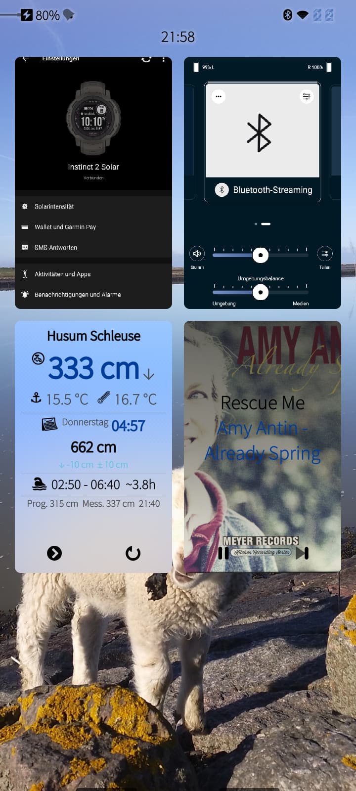

My Garmin devices are working, and I can now control EQ Settings of my Dockin speakers using their Android software.
The highlights are my Unitron/Sonova AG hearing aids.
Sometimes a control is not there. Swiping on the desktop and back helps. Everything happens in real time. Tested whilst listening to music with SFOS Apps
