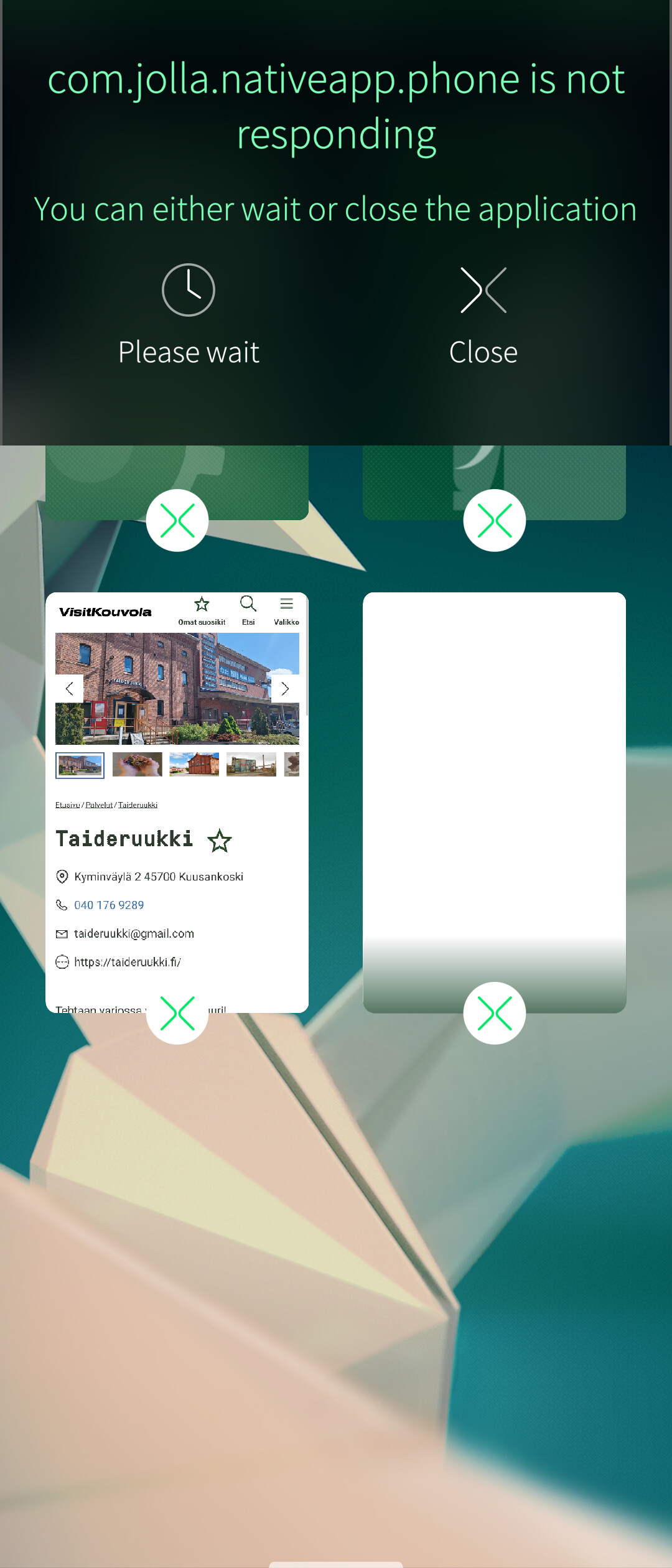

I remember seeing a error notification “com.jolla.nativeapp.phone is not responding” a couple of weeks ago. I don’t know if it was related to the issue at hand, as it didn’t seem to occur at the same time when attempting a call, but it did raise suspicions it might be related to mute calls. Please see the screenshot below.

Screenshot of an error message. I’m not sure if it’s related to issue at hand. It occurred randomly around three weeks ago (16.7.2026), not related to a call as far as I recall.
Is any audio working? Have you had GPS enabled? You might try to restart the Audio Subsystem from Settings → Utilities - but in general audio in calls on a 10iii works fine.

Yes, audio in general works. For example audio from notifications, alarms and such work fine. I think the call audio after rebooting the system work fine too, but the problem arises after phone has been powered on for a few days at least. Could it be a RAM issue if the error pictured in the screenshot is related at any rate? I don’t know.
